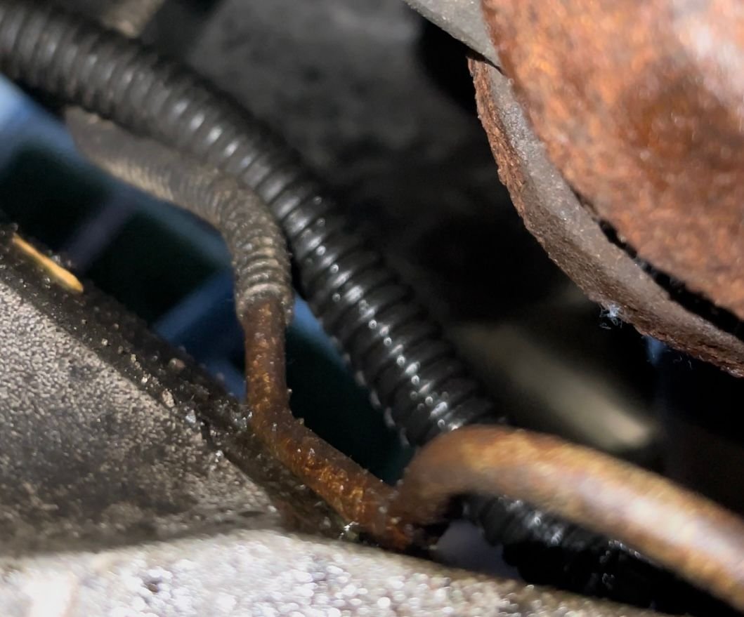

Looking for this brake line, nj weather finally punctured through it

You might give some details as to which line it is - hard to tell from the picture unless one knows all versions of the car inside and out.
I.E. what year? Rear lines on the 2000 and up cars go from the (front mounted) BPMV through the tunnel and are at least two pieces if not three - there are couplers visible in the rear of my 2001. Older models with rear mounted EBCM / BPMV are completely different. All critically important.

this is the line I’m looking for, it’s a 2002 with active handling

So that's the passenger side before it starts heading upward to the soft line coupler?
Those hard line couplers between sections E and D looked pretty rusty on mine, and I think they screw together so you might have to do some bending on the forward pipes to get them apart / back together without dropping the entire drivetrain. Probably not a good idea with old, rusty hard lines. Might want to consider cutting the descending part of section E (assuming you can find a rust-free spot), flaring and putting a union there.

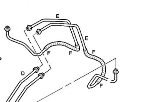

there is definetly not enough to flare a line with a union. The lines that it connect too arent really rusted and looked replaced at one point so they are newer. I was really hoping I could find just that line that I need. Its the driver side line in the diagram. Been looking all over and cant seem to find one.
This may work....01-04 Corvette C5 Z06 Rear Brake Line LH | eBay

thats the exact line, I got my Lh side line out and took a picture of it and it broke in half. Since I need the car by thursday I am going to rent a brake line flaring tool and bend it how the factory one is done. Going to do both side in the rear.
