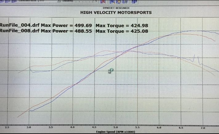

Originally Posted by 493lszosix
This is a comparison of my fast 102 vs my msd on my c5z, msd is in the blue you can see around 6500+ the fast starts dropping off but either intake will pickup over an ls6 intake, the 102 made around 30+ over the ls6 on my set
up
True, but the FAST had the MSD covered by a wide margin below 5000 RPM. Just out of curiosity, what are the details on your engine? Is this a street engine or a track car? I can't see the OP's 5.7L making this amount of power. I would think his combo is going to be closer to 400 RWHP. In that case, a 90mm snout intake like the FAST 92 would be a much better choice.
the graph was just a comparison between the 102 and msd for anyone interested, mine was a street car that was drove a lot and did a lot of 1/8 mile racing….it’s basically ported tfs 215 heads, lg headers and cam g5x3, Tony ported the msd, ewp, underdrive pulley, eventually made 508/440 with a little more compression, 12:1 and a vacuum pump, 93 octane, this was with 4.10 gears so I like to say it would dyno higher through the stock 3.42’s lol
up
So what was total cost for 30hp??
well I did the ls2 throttle body along with it so whatever the price’s were for a fast 102 and tb around 8 years ago, I can’t remember
