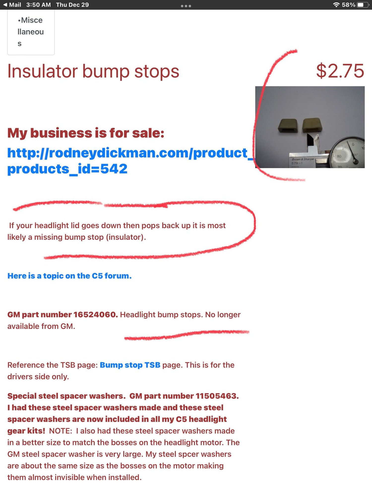

You can also use the manual adjusters. The one that keeps running: try turning the adjuster a little bit. I noticed I was able to get it to close softer and it stopped buzzing.
If you are missing any of the plastic bumpers, you can buy replacements from Rodney Dickmans website
