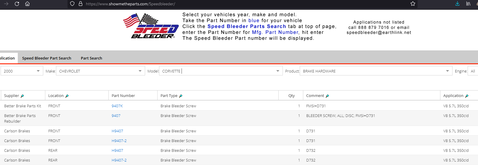

Their parts finder at SpeedBleeder is rather odd. Below is the 2000 Corvette info. But from there you have to take the part numbers shown and do a specific SpeedBleeder search.
The 9407K Speed Bleeder is an SB1010S or SB1010S-SS
I'll leave the other searches as an exercise for the reader.
Probably better off to either send them and inquiry or go with the Summit kit someone posted above.
Screenshot from SpeedBleeder site parts finder.
