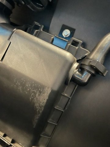

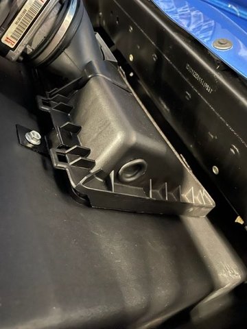

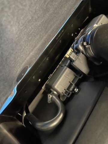

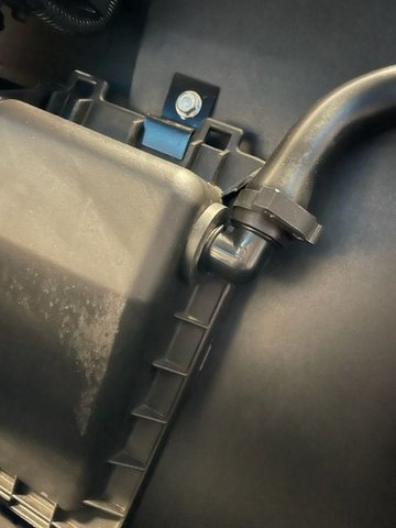

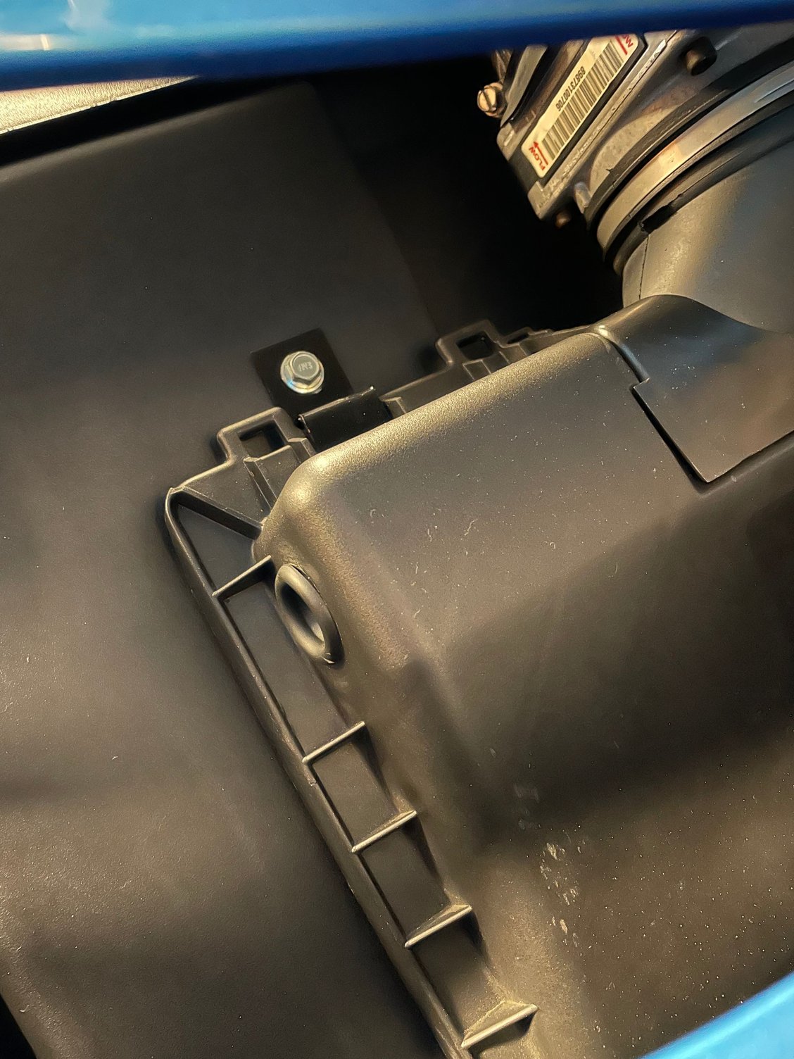

Here are some pictures of a flip tie mod done without zip ties.

Old Jan 10, 2023 | 03:27 PM
MetalMan2's Avatar
MetalMan2
Joined: Dec 2018
Posts: 2,663
Likes: 1,389
From: Orange County, CA
Very nice!
Any chance you have pictures from the underside?

I’ll try to take some next time it’s up on the jack. Too low to get my big head under there. I’m running the OEM Delco filter so it’s just a rectangle of pleated white paper. And no I’m not concerned about water intrusion. You’d have to drive into a 12” deep body of water, at speed, to even have a chance of that happening.
