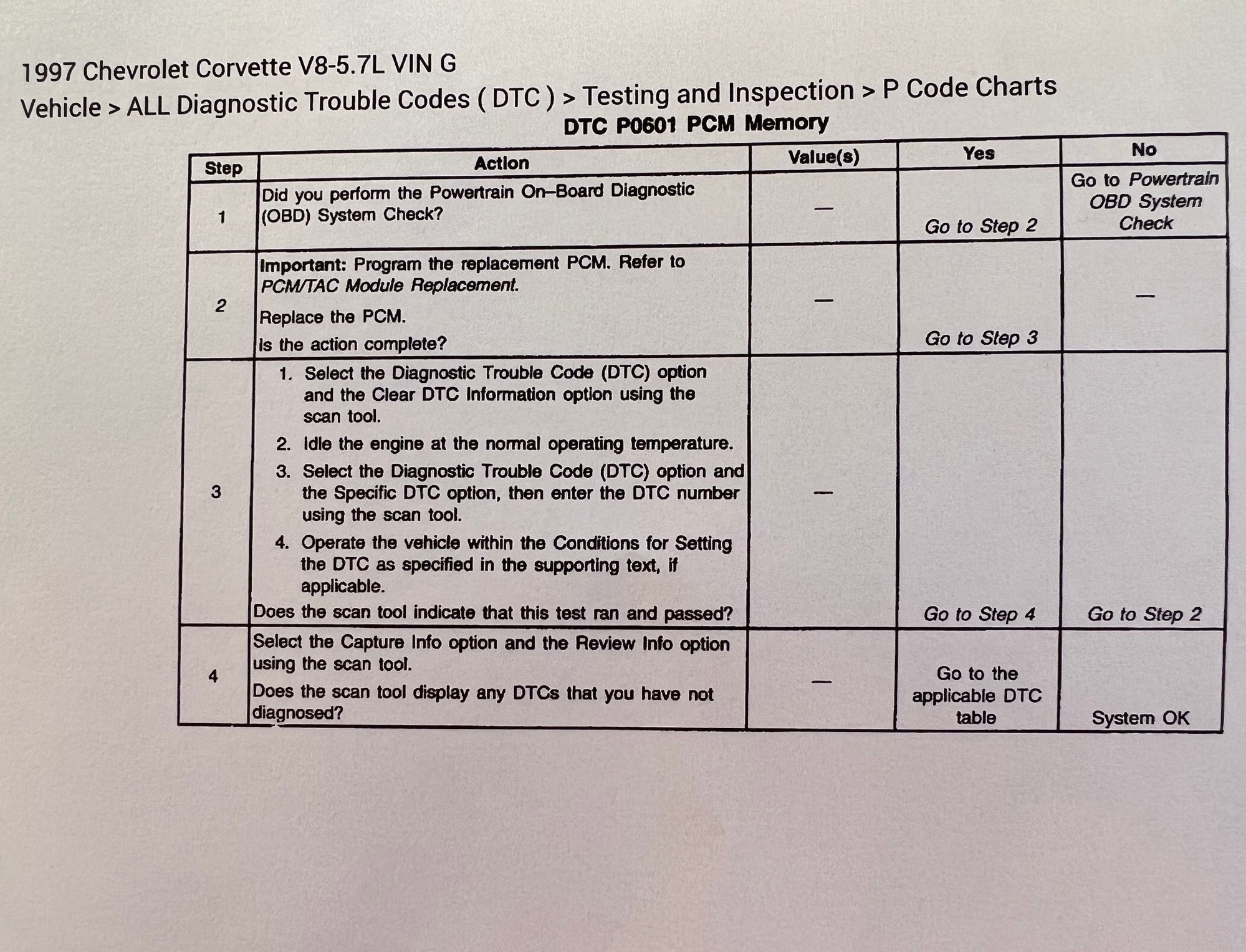

Bob, you can get codes whether the engine is running or not…P0601 is a PCM code which is comparable to a computers “blue screen of death” !!…this is usually a PCM change…OUCH !!…if you have a voltmeter unplug the MAF sensor and see if you have 5 volts on the yellow wire with the ignition on…the PCM supplies 5 volts to many sensors on the car and I’m curious if it’s not putting out 5 volts and is basically “dead”…the MAF is an easy sensor to get to…below is Alldata info for the P0601.

That code indicates the pcm has failed a checksum test

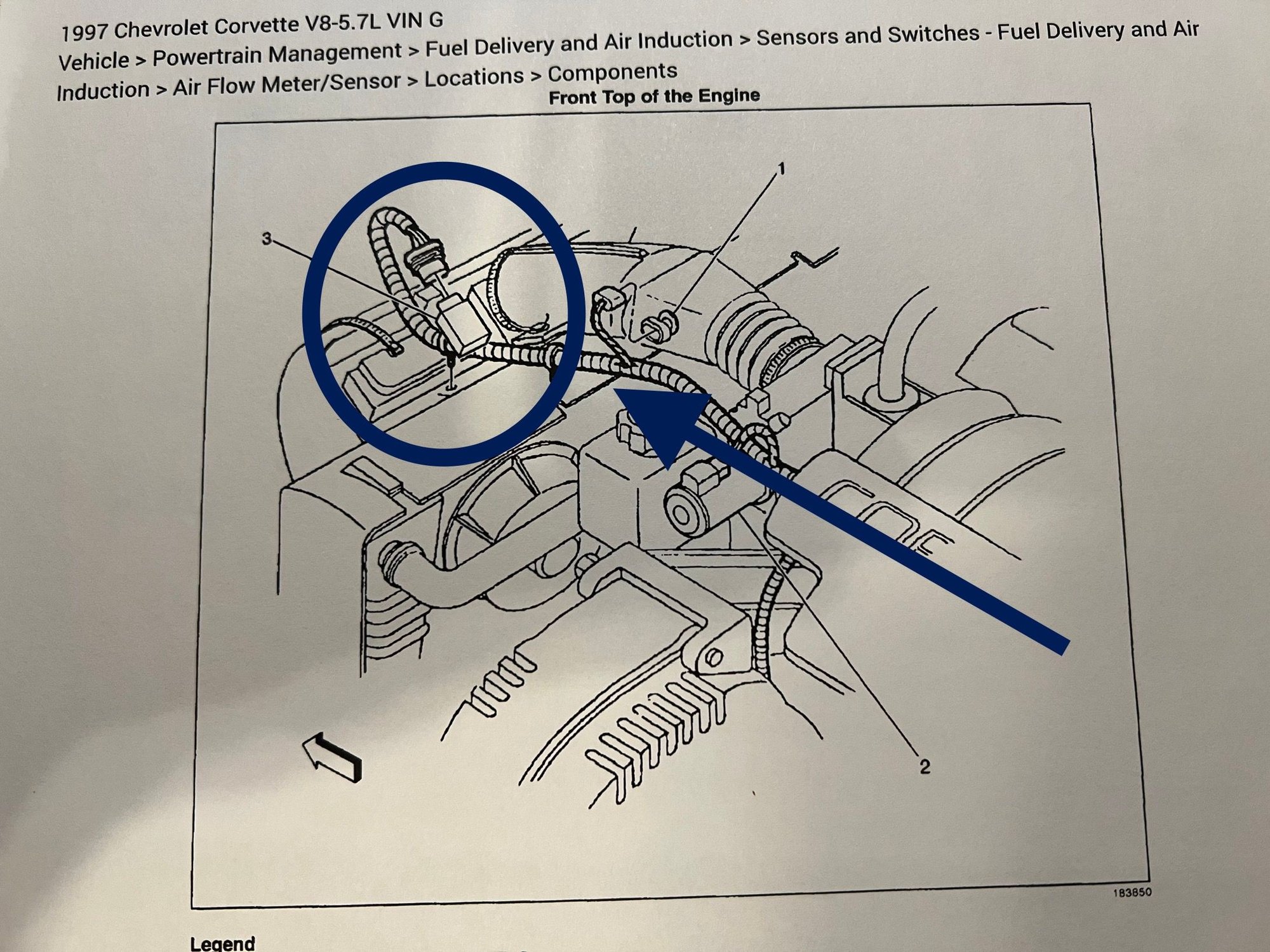

Where is the MAF sensor?
I can check voltage tomorrow.
Then let you know.

MAF is aft of the air filter…should be 3 wires…yellow, pink, black/white.
