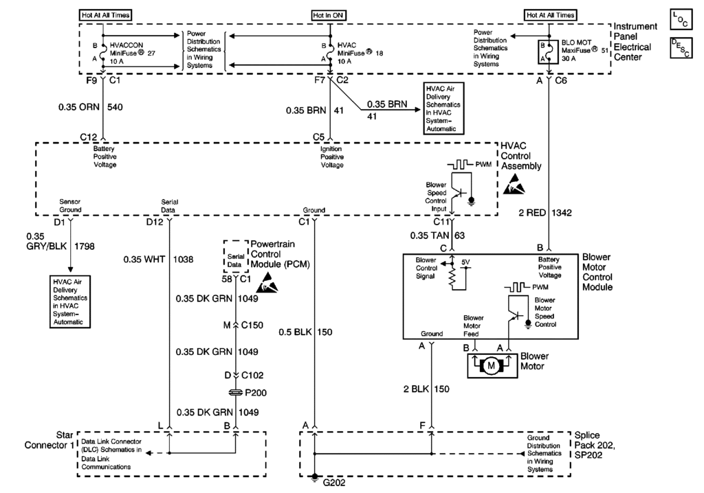

Everything lights up on my dash when I turn on the ac or heater. But nothing works. Outside temperature lights up, fan displays when I turn up the fan to hi, when I turn up and down the temperature it shows movement, but nothing.
Any ideas

Have you checked all the related fuses for the climate control system?

I am not the best at reading prints. It looks like I should be checking for three (3) fuses related to the HVAC system, is that correct?

Are you saying the blower motor is not working ??...little confused on what you have going on ??

Sorry for the confusion. I am saying everything lights up on the control panel on the dash. I can see the outside temperature, and when I function all the ***** and switches, every display moves accordingly, but I have no heat or ac. Absolutely nothing comes out of the vents. I put a piece of tissue paper on the deforester vents, and no movement when I turn the deforester on or off. I hope this helps me explain my issues.

So your blower fan is not operating...if you have a DVOM can you look at the wiring diagram (blower motor control module) above and try to diagnose this ??...if not find an auto-electric shop in your area and they should be able to fix it...other than a blown fuse this may be a little difficult to diagnose if you do not have basic electrical knowledge.

Yes, check the 3 fuses
