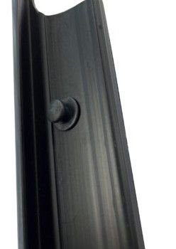

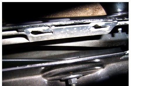

I had to remove the door panel. The receiving slots on the door are thin and very fragile; to remove, tap the trim back lightly and not too far. I had to repair two broken slots with epoxy then sand the openings to size, they might have been broken from assembly at the factory. The replacements from RockAuto turned out to be a better quality than the originals though. Here's what the broken slots look like with some epoxy before sanding to shape, they go from a large slot to a smaller one to retain the trim pins so as the trim is pushed back into place it's held there in the smaller slot. The difficulty is keeping all the trim pins pushed into the door at the same time as the new trim is moved back into place. The trim pins are also prone to breakage if too much force is used.

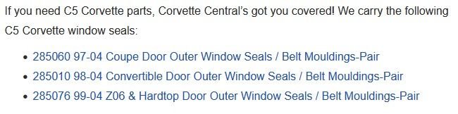

Thanks for the pic and info fast. This is what they show over on Corvette central.
