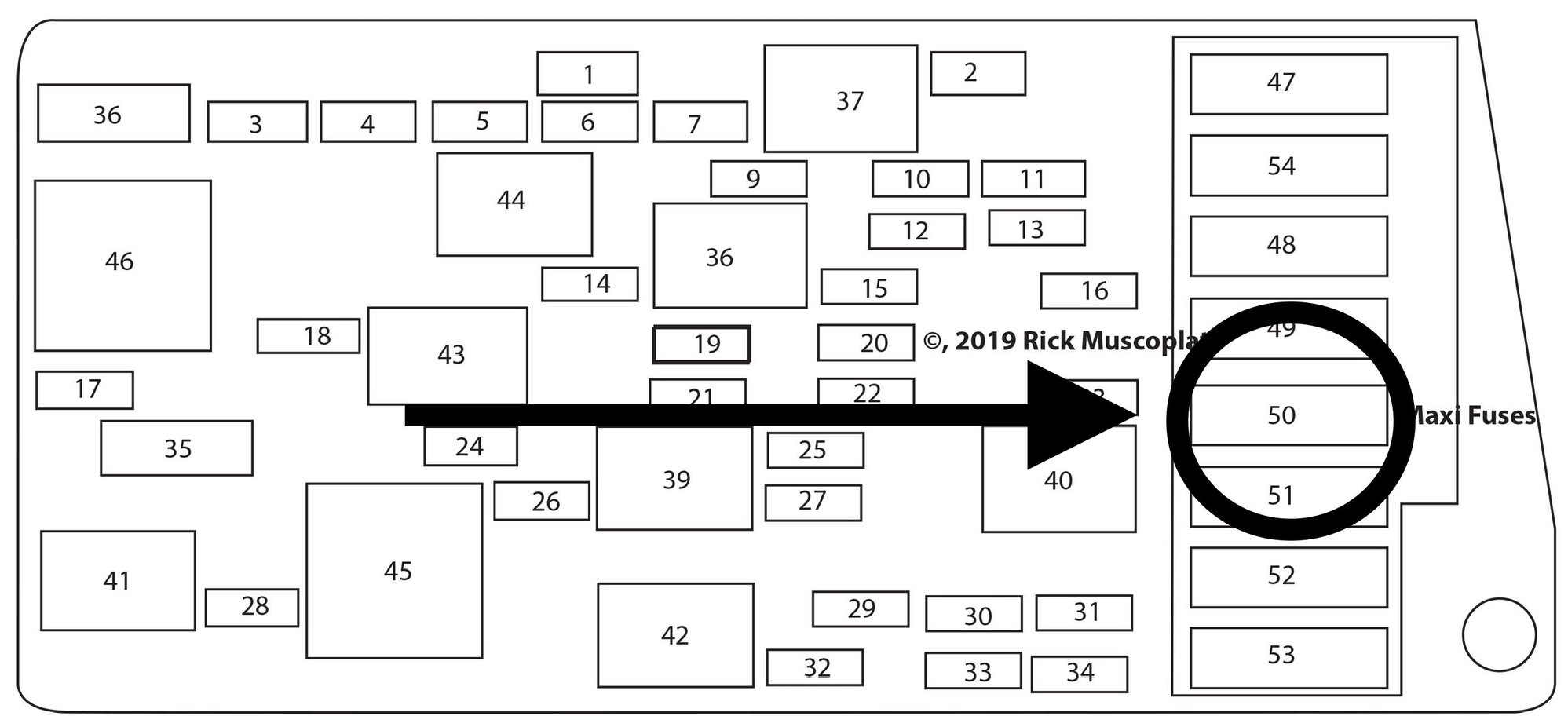

Your secondary AIR pump located in that area operates for around 30 seconds when the car is first started…that’s probably the sound you are hearing..to verify remove fuse 50 (AIR PMP) in the underhood fuse block and see if the sound disappears…it is a maxifuse which are one of the large ones circled in the picture below….video below to show better location.
