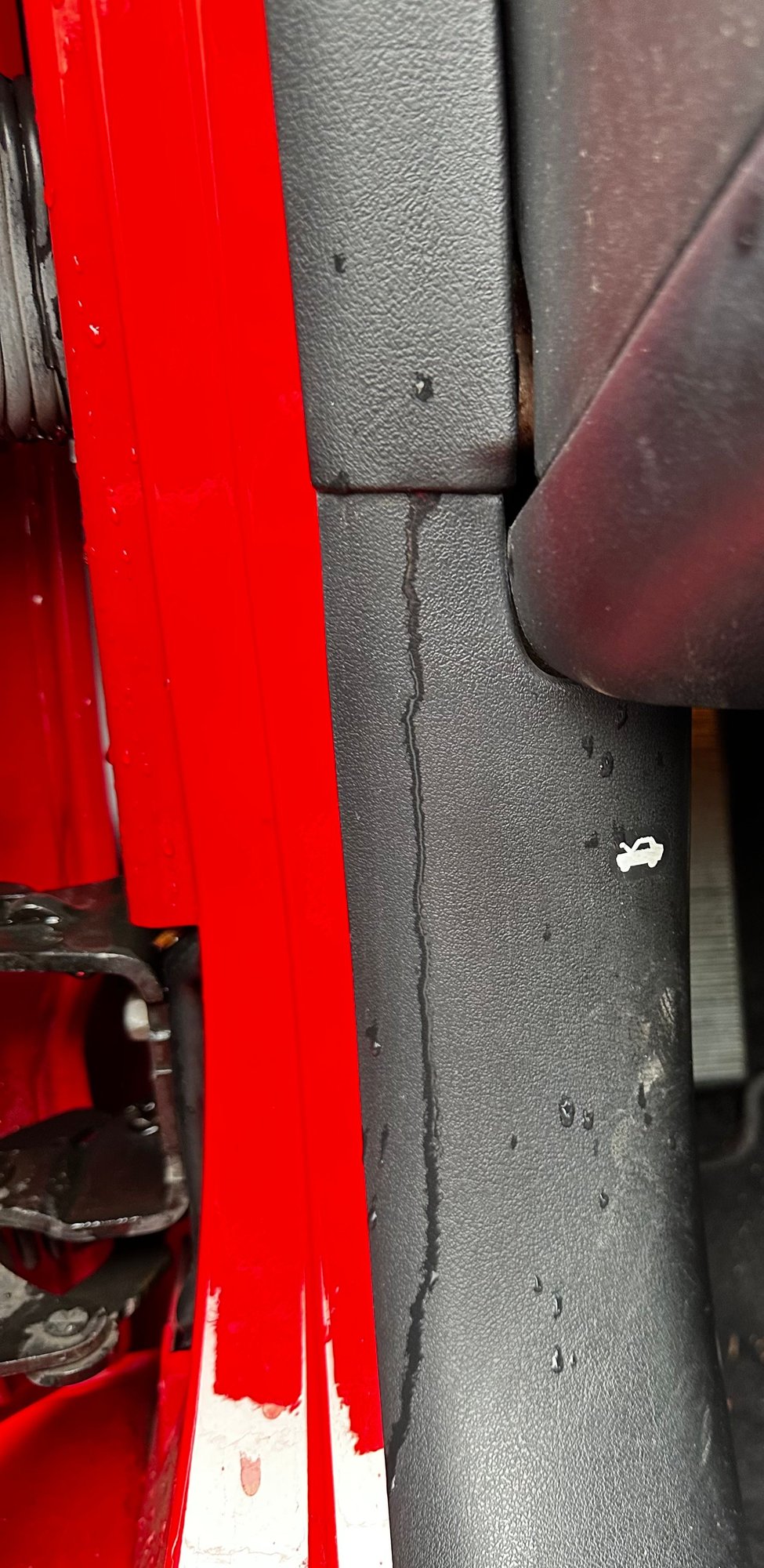

I recently had the windshield replaced on my ‘99 FRC. The mechanic did something wrong & now there are water leaks on both sides. Both floors are wet after a rain. The mechanic denies responsibility, declines calls and doesn’t want to cooperate with fixing the problem. Both rain gutters were cleaned, issue persists.Look at the attached images. The leak is identical on both sides. Some water dripping down the side wall and more water dripping down right next to it. The second picture from the top shows how it is on both sides.

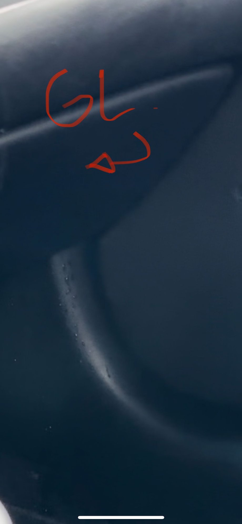

This is where the water is coming from on the drivers side.
Gl for glovebox - you can see water dripping down from under the side of it right next to the speaker.

there's also a metal strip on each side underneath the black trim & seals that often gets torqued unevenly and/or bent in the process, and that'll allow water intrusion.
went through this with my 2000 about 12yrs ago. our local dealer had a guy really good with corvette stuff, so i had him fix those, and the water stopped.
