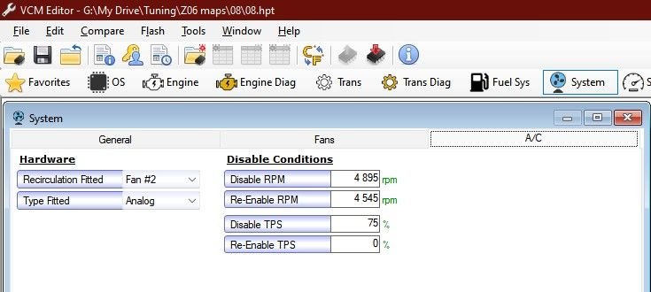

Note that he stock setting is to disable the AC at 100% throttle (WOT).
In your case, the only option that could apply is to increase the re-enable setting, so that you do not have to fully release the throttle to get the AC running again.

If i remember there is others parameters. There is a high, low psi sensors that can override the RPM.
