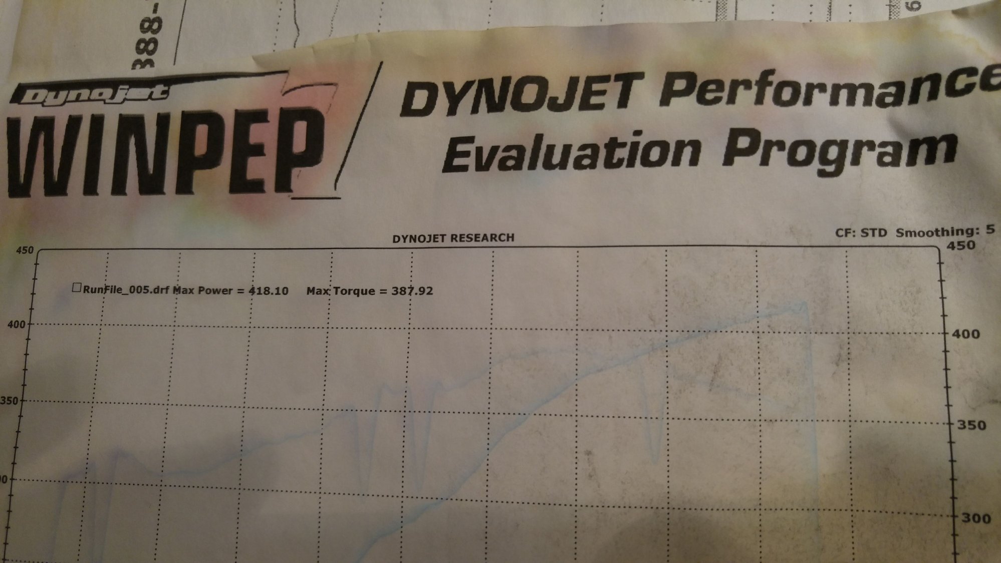

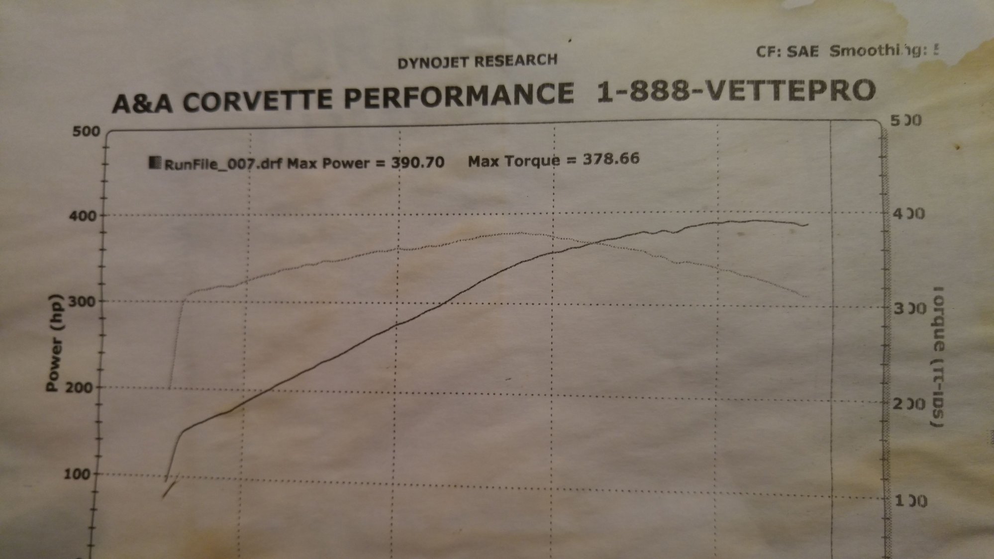

228/228/112 with ported 241's
232/236/113+ cam with ported 241's (software glitch screwed up the printout and I spilled water on it)
Above examples to show the gains a well ported 241 can make. My machine shop could have gone even further with them but I only wanted to pay a couple bucks to have them retouched.
I had mine ported in 2003 for $1200 with upgraded springs I was in for $1700. I still run them 20 yrs later (new BTR springs) with boost.
I saw a minimum of 32rwhp out of ported 241s twenty years ago. CNC programs today are more advanced. Getting on average 8 more rwhp out of them.
So "opinions" above stating 15 to 20rwhp are totally incorrect.
