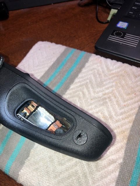

Having some issues changing out to led map lights ? Any advice ???

If you mean the ones in the mirror then yes. It is easiest to remove the mirror entirely and work on a flat surface. The metal bulb holder brackets are tricky little devils and can come out of their slots so be careful.

I was referring to the auto dimming LED lights in the rear view mirror. My mirror doesn't use a lamp, it uses 2 circuit board with LED soldered to them. The color temp. is 2700K or 3000K. I'm looking for 5000K but can't find anything on the internet.

I just want to change the map light LED color temperature.

Thats a much different mirror than what I have. I put in 6000K leds in my mirror.
