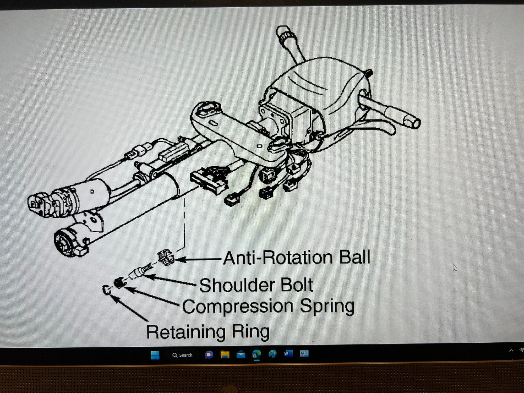

The sensor is part of the telescoping actuator…looks like a big job !!…did you contact that auto electric shop ??…I’d let them look at this DTC before shotgunning this part !!

Well that is the thing, I get this B2860 code, but the telescoping column works fine ? Do I need to pull the drives seat to get at it ?
