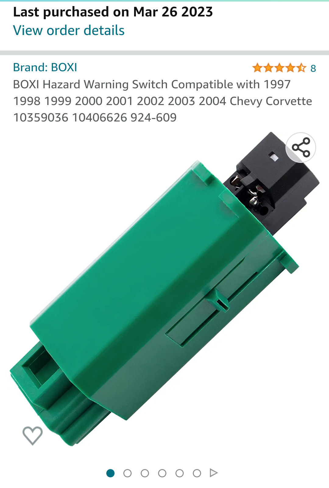

l change the hazard switch still the same problem. Very hyper when flushing 4 way even when the car off same problem . l have no bulb burn all the lights working normal .. l have hyper relay already any idea ?

But are the hazard switch when it's get hyper it's mean bad switch ? Because all my signal working normal only get hyper when I press 4way hazard so decided to replace the switch it's gave me the same problem... Are all the switch are the same or no ? Because the one l buy from Amazon
