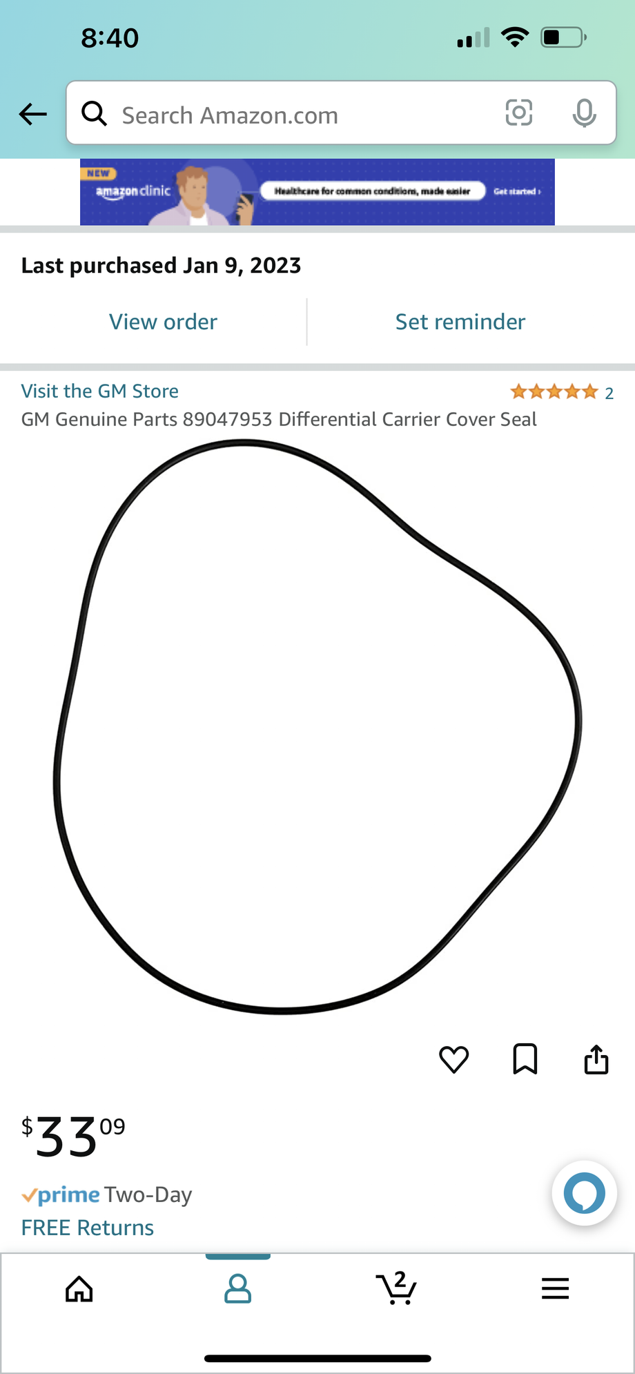

The rear cover gasket is called an inspection cover gasket/ O ring. If you buy a differential cover you get one for the side.

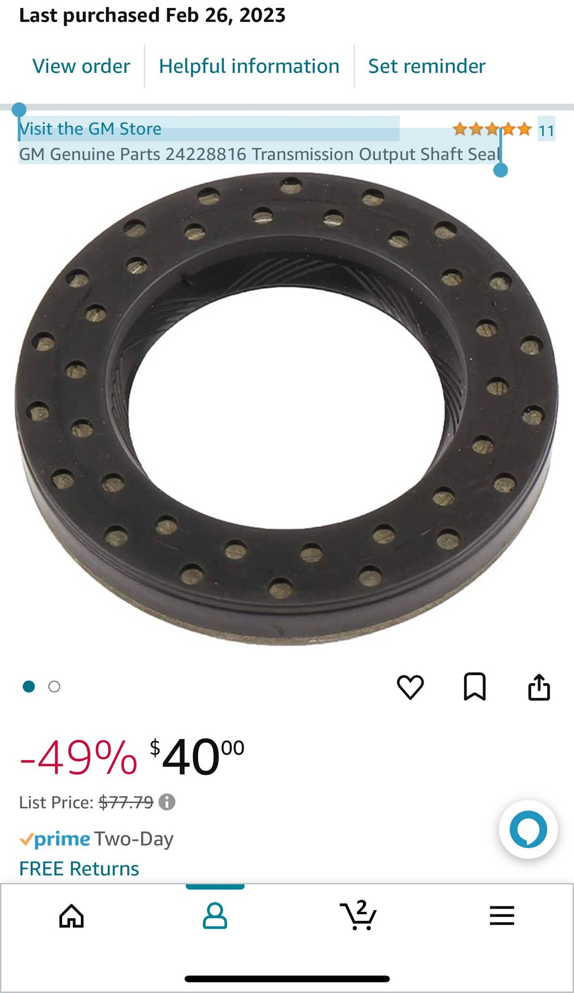

GM Genuine Parts 24228816 Transmission Output Shaft Seal
This is the seal in between.
You may or may not need these I replaced both sides which was about $80 total.

This is the gasket I was saying goes on the side not the rear cover for ref
erence
“I replaced both sides which was about $80 total” you replaced the trans side and diff side with this seal? I attempted the job myself and a brown quark seal went into the trans side and I put this one into the diff side. Must’ve been late cause I didn’t care to dig into it this much but now I have the drip again. I appreciate any reply’s. Back to rock auto
