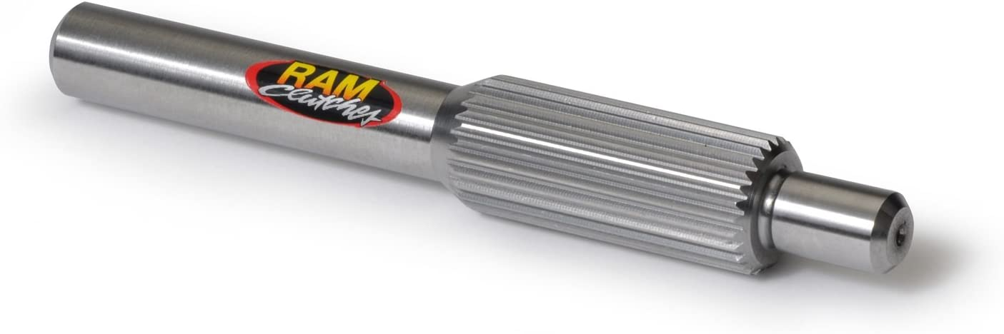

when i was pitting my car back together from my clutch job, i remember my TT was also not going in until i realized that the cheap plastic clutch alignment tool did not align my clutch correctly.
i then bought a nice machined metal alignment tool and re-aligned it and the shaft slid right in
this was the piece i used
Amazon Amazon
(read the reviews)
