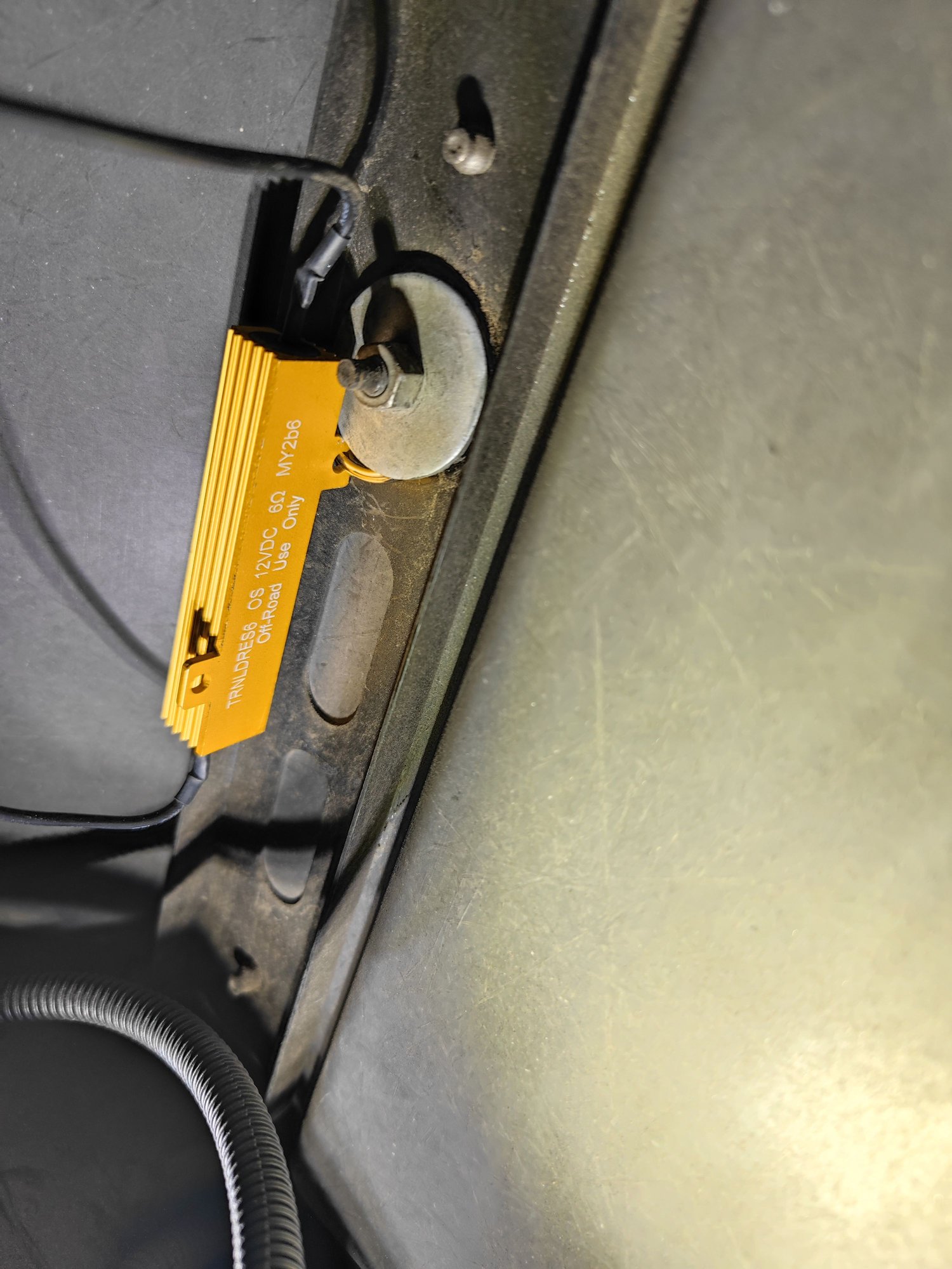

I followed your lead tonight and installed the Sylvania resistor to my 3rd brake wires
I mounted mine by unbolting the large nut on the metal strip that runs up the back of the body above the bumper
I ran a metal key ring through resistor mounting hole and put the ring behind the large nut. This is forcing the resistor to only be touching the metal strip which should be fine for the heat it will give off.
I haven't driven the car yet but this resistor mod will likely resolve the c1295 as it did for you

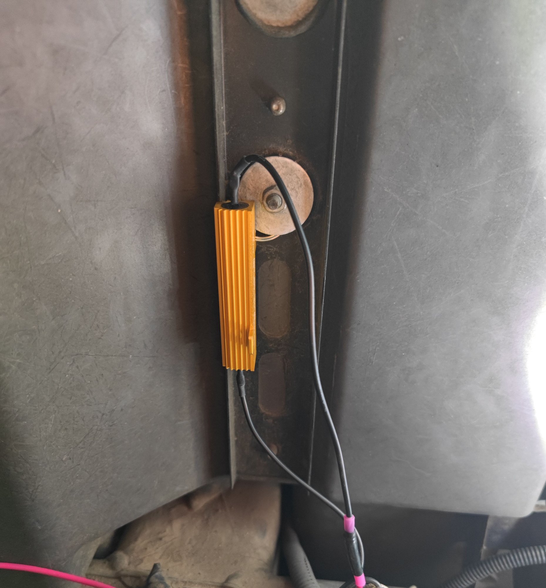

Originally Posted by link9a
A lot of guys they ask me how to fix the code 1295 ... I post a video to make it easy for the everyone ...
https://youtu.be/n91q-U_mSLM
Great 👍 ... actually l change the location for that resistor because l add a 4 resistor for the taillights ..lwill post a picture for that

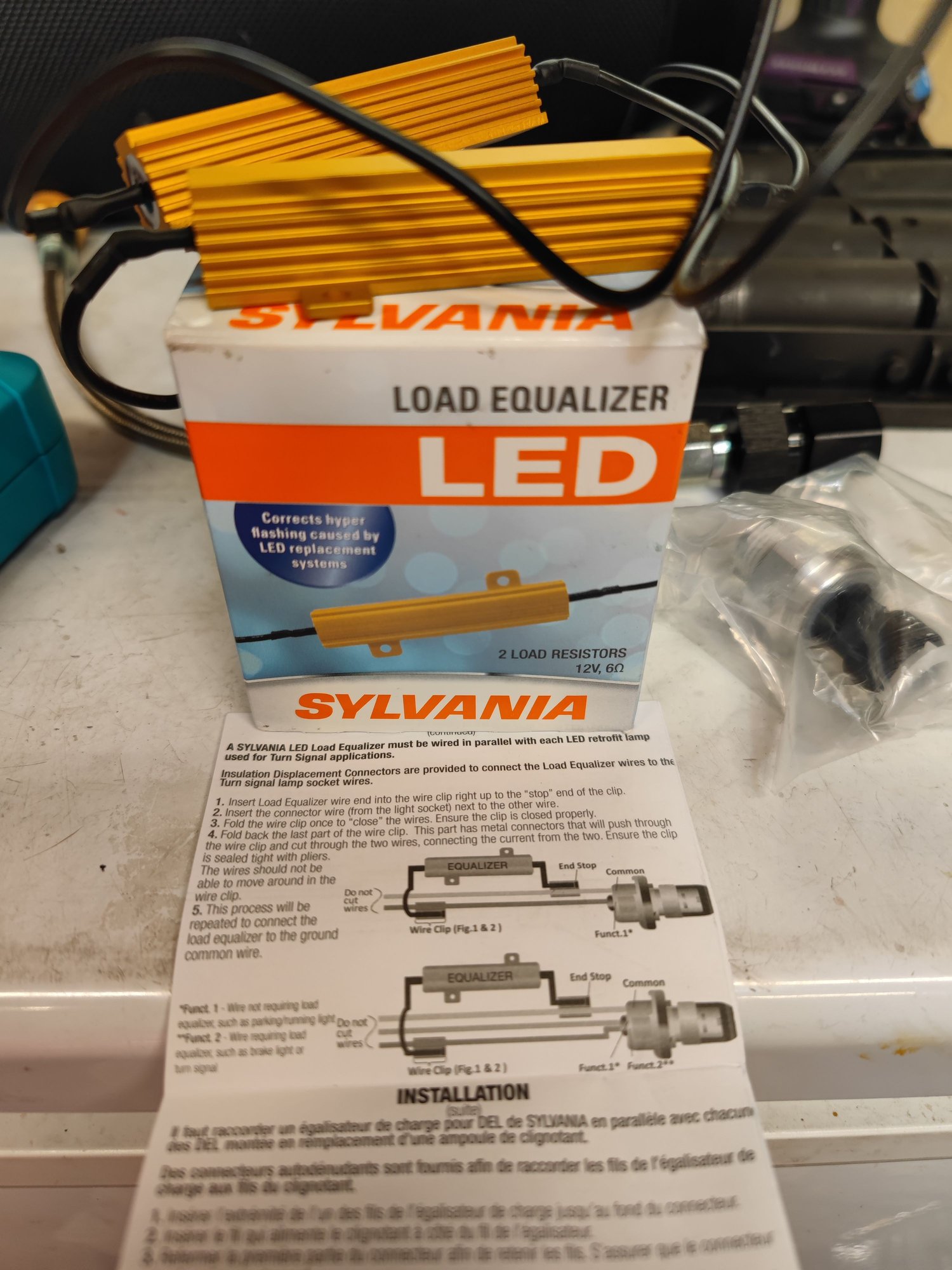

Load resistor for each tail light the one from Vette lights
To Video. ... No more code 1295 service traction control
