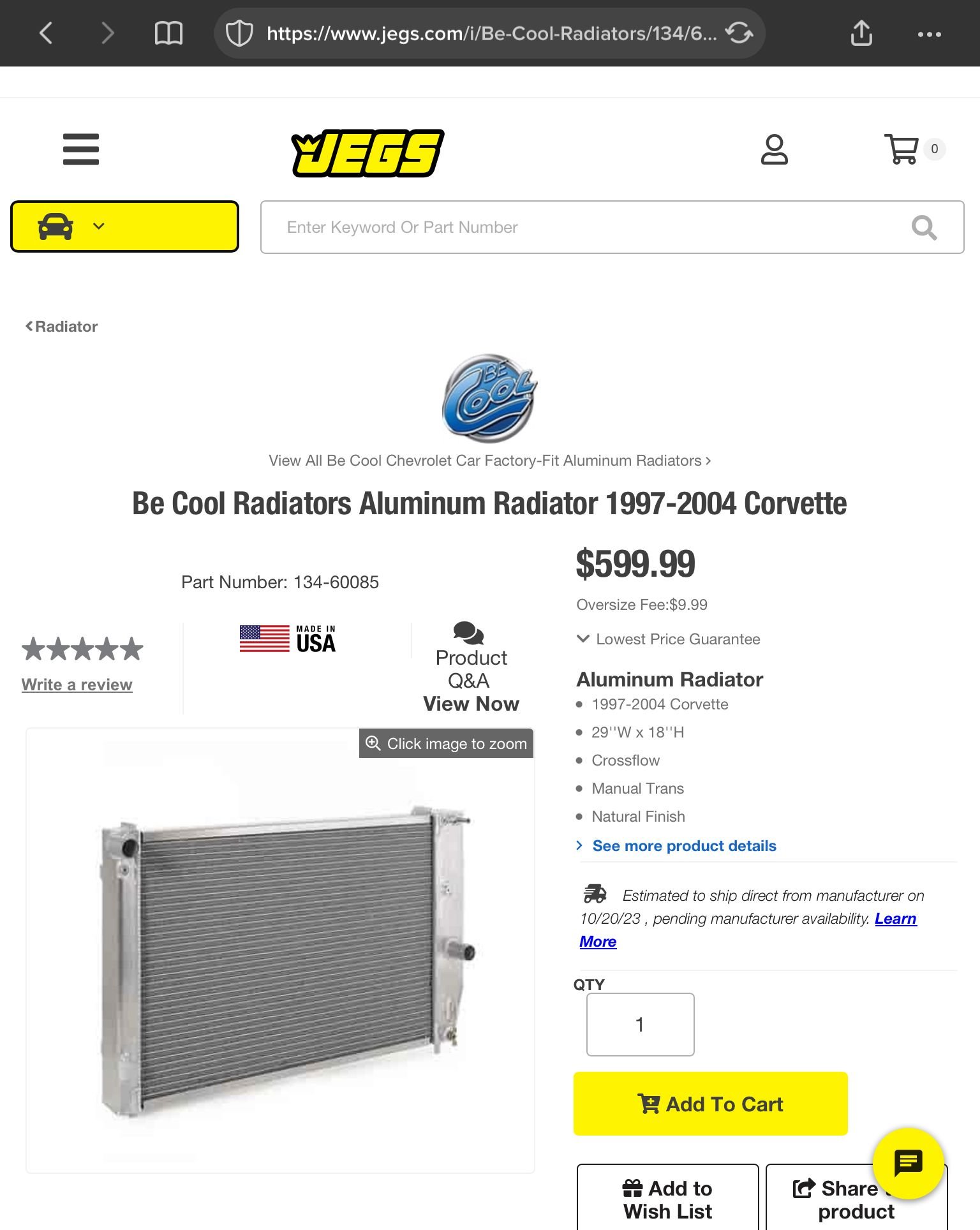

From: Florida
Be Cool is also very high quality… Made in USA.
https://www.becool.com/product/radia...-cool-radiator

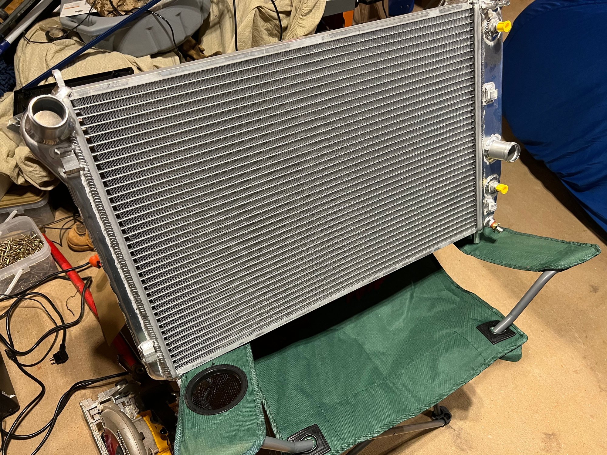

I ended up calling Dewitt directly and have one on the way. I went with buy once cry once.
After investing in the built motor and what’s looking like a transmission it’s cheap insurance.

Jay was the guy who took my call.
He was definitely helpful and got it over to me lighting quick. They definitely take pride in their welding.
