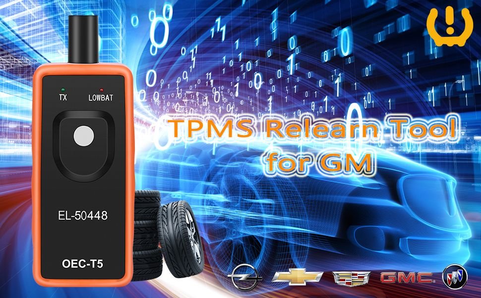

-03 doesn't use magnets.
Buy this, very cheap and DIY
Amazon Amazon

I hate to refute his statement because the tool is most likely what the OP needs, but...
GM used 25731358 / AC Delco 25773946 as oe from 2001 to 2004 for domestic cars. These cannot be triggered by RF, only by a magnet.
I suspect the tire shop sold him universal sensors which lack a reed switch. That doesn't mean they're incompatible, they just can't be triggered with a magnet.

That's worth a try, but I've found most of the universal / programmable sensors I've bought in the last 3-4 years lack that pressure change trigger logic also. Conversely, every sensor made after about 2006 is equipped with a 120khz antenna / trigger system. $10 is a small price to pay to not have to put air back in afterwards.

Since there's little to no point in rotating tires side-to-side, and impossible front to back, I suggested @lacebm2 take it back to who installed the sensors and ask them to trigger them with their tool for relearn. That way he's not out of the additional $10 and doesn't have a tool he'll likely never use again sitting in his shop / garage.

So you want him to spend time making an appointment taking time out of his day...all to save $10
I'll tell you what, my $10 paperweight sure came in handy when my young daughter came over in her 2018 Chevy Cruze with an inop tire pressure reading. Sure beat having her take it to the dealership
