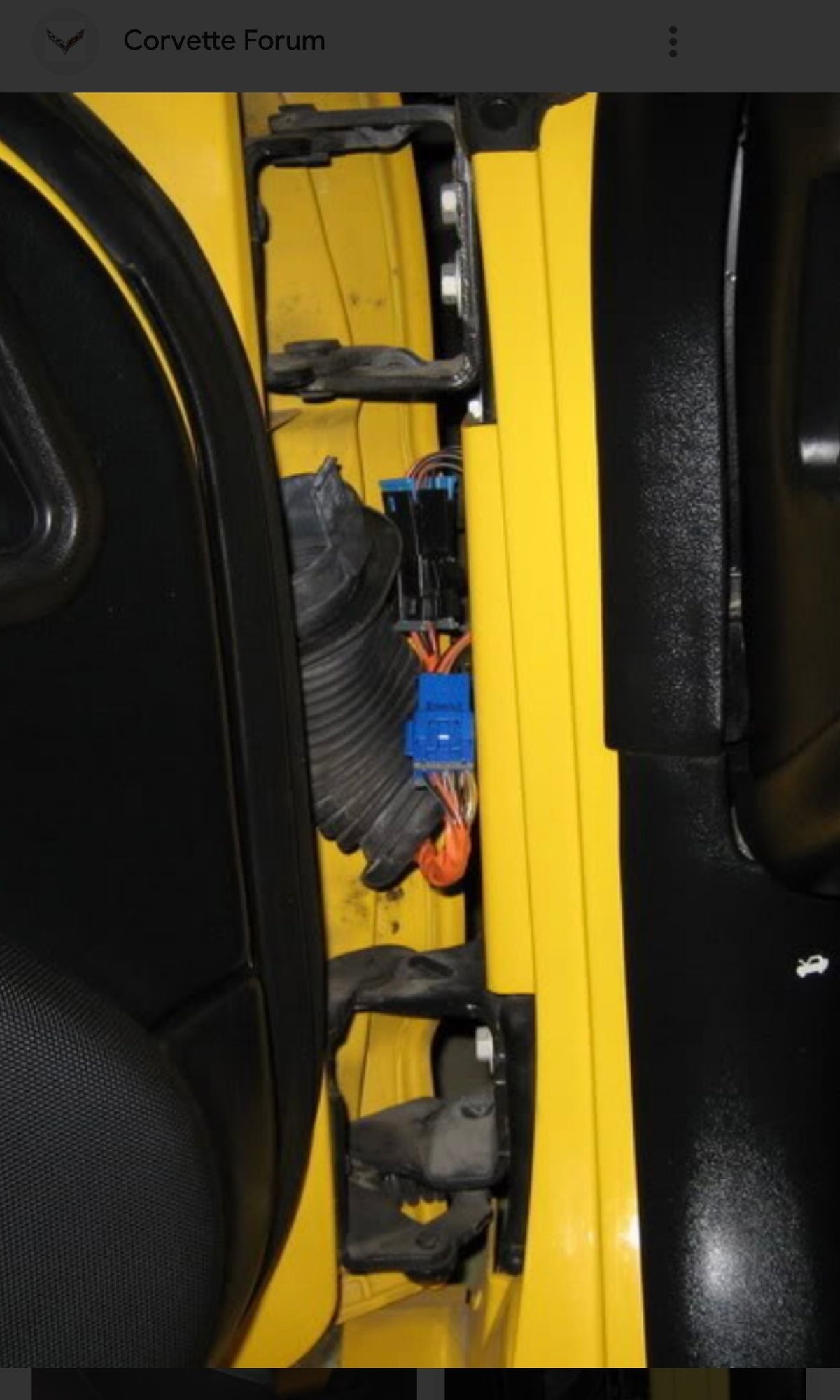

I see there is a Superior Auto Service in Rockville and they do electrical repairs…you can try them…just shake that rubber boot a few times and see if it starts !!..pic is passenger side…drivers is similar.

Got it- thanks for the picture and the Superior Auto Service suggestion. Never heard of them.
I pulled out the boot conduit from the door and gave the wire a few tugs. No happy surprise, but definitely worth a try if you have heard of it working before.

Since shaking and pulling did nothing, disconnect the connector and make sure all the wire connections are tight. A heads up, doing any electrical stuff, I suggest disconnecting the negative ground from the battery.
