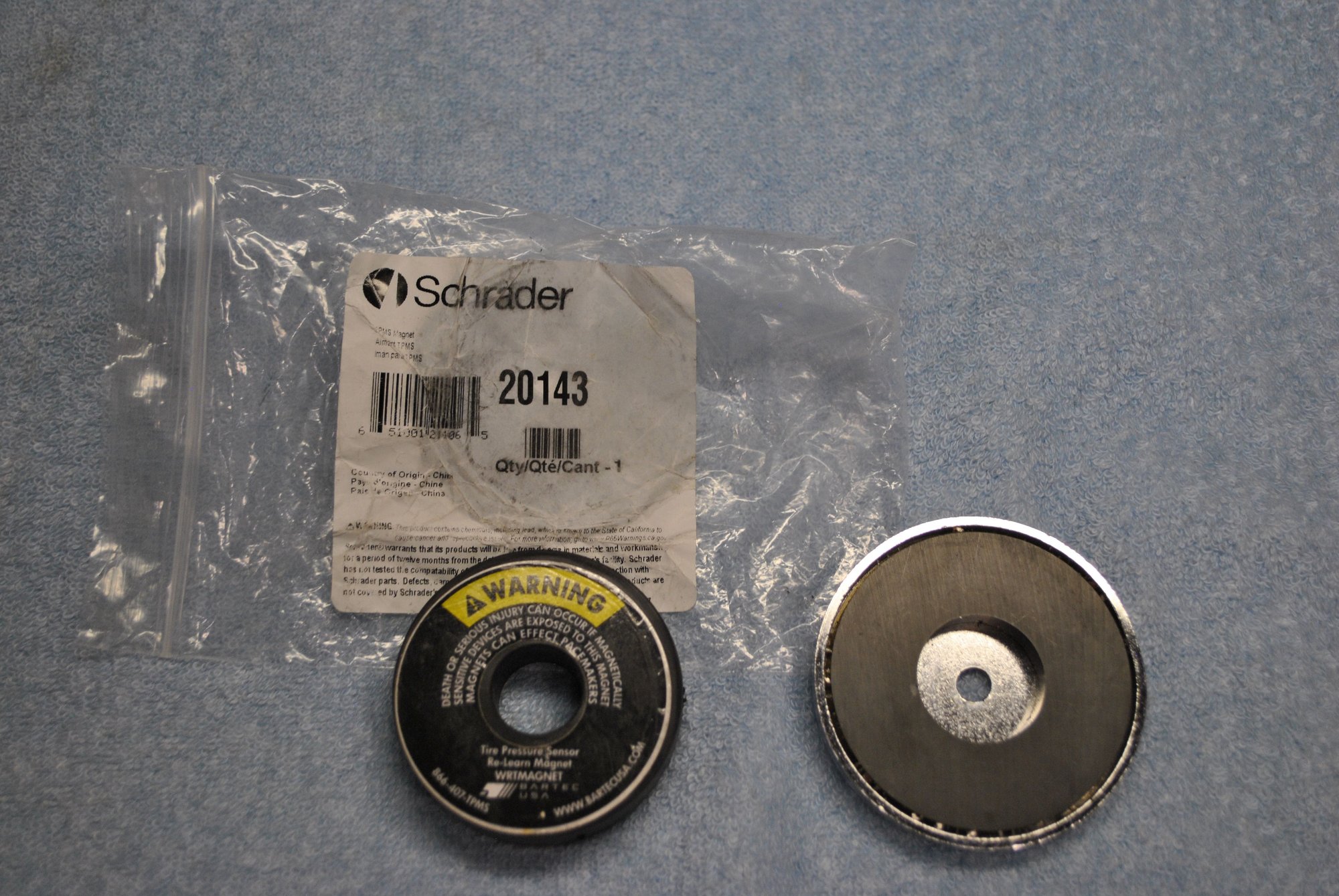

This is what I used....
the one on the right is a "Stanley Hardware" magnet, from the hardware store, that I have used with success, too.....

The Shrader magnet in your pic is the one I borrowed last night. I will have chance to try it later this afternoon.

Well dang, the Schrader magnet didn't work either . Looks like I'm on to another brand. Going to fire off an e-mail to Dorman and tell them they need to rework their product...
