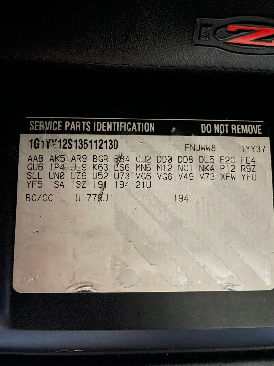

Originally Posted by C5 Diag
Being that yours is an 03 is your fuel pump at the bottom of the tank…if on top your RPO code in your glove box will say “FFS”…do you know ??..I may want to hold off on replacing the fuse box…where and how were you checking for this voltage drop ??
Here is a picture of the tag. I looked up some of the codes, but I haven’t looked at this before so I wasn’t sure of which code you were referring to.
Your fuel pump should be at the bottom…RPO codes go in alphabetical order and I don’t see it…where are how did you check for this voltage loss ??…you can also go by the VIN to check for which system you have…just easier to look at the RPO’s…they changed halfway through that model year.
