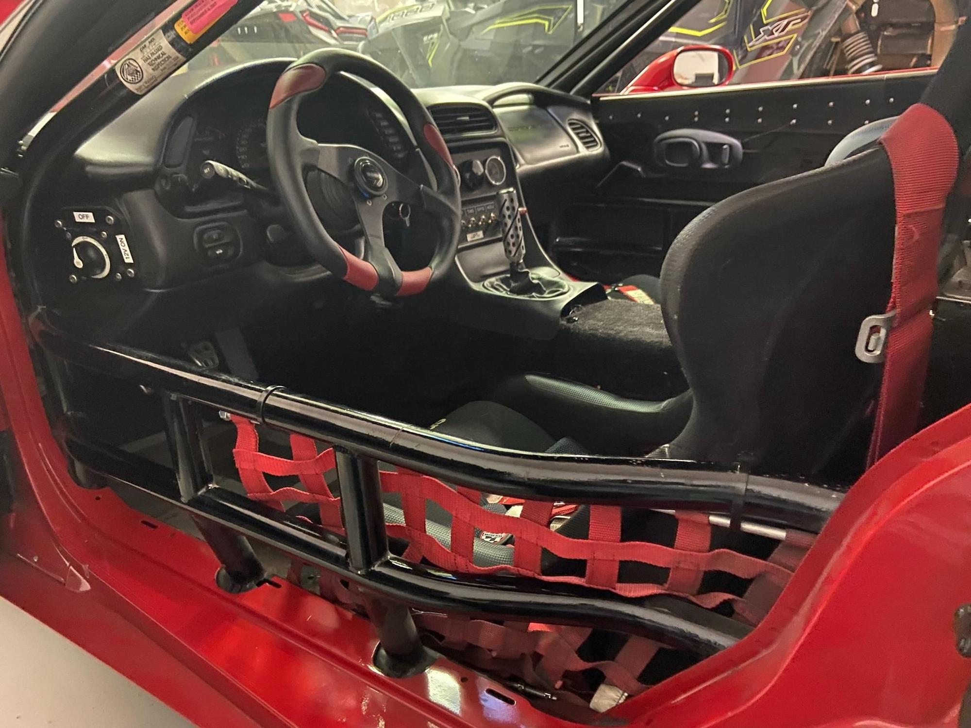

Pic of the car for attention.
I have a '99 C5, full race, with a swapped LS3 stroked to 417ci. NA, fuel injected, making about 700bhp before tuning.
