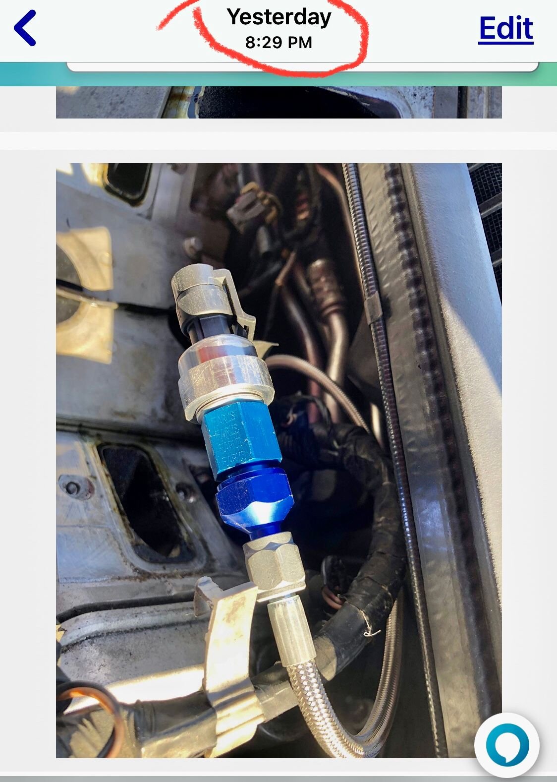

Here’s a relocater kit on Amazon. It’s set up for the standard Chevy sensor.
To adapt for the Buick sensor the fittings circled in red would be replaced with Aeroquip fitting below.
Some people zip tie this to the fuel rail, or just lay it up under the cowl.
An option is to just buy the individual fittings and hose for about $50.

I got this one . looks better and a bit less $$ ........Working dandy . The thing I was weary about was dropping pieces down the intake ports . They are almost straight up.
https://www.ebay.com/itm/176810135074
