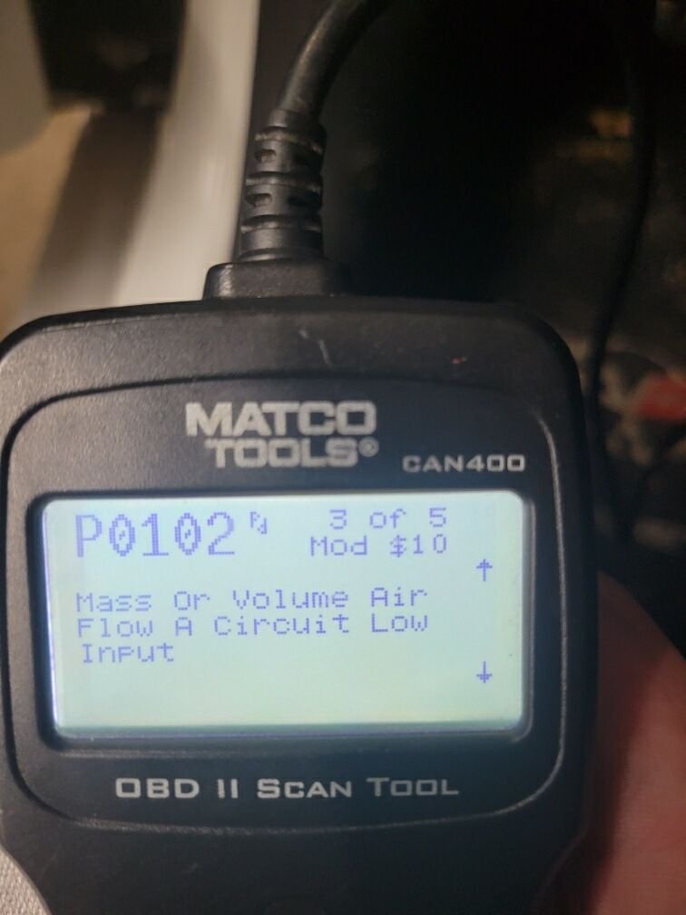

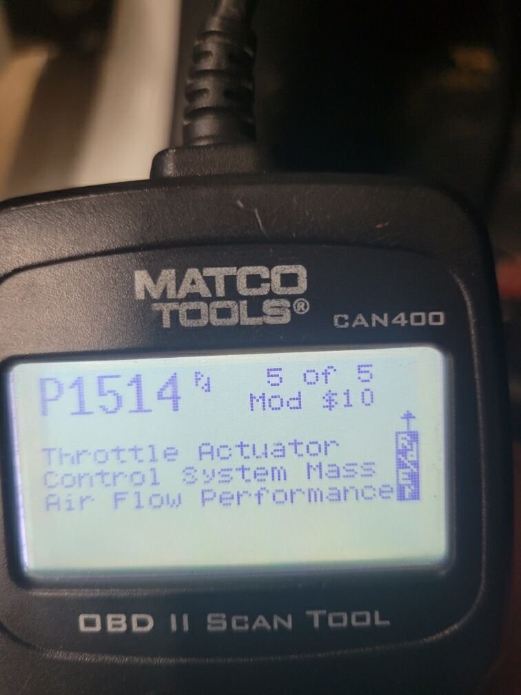

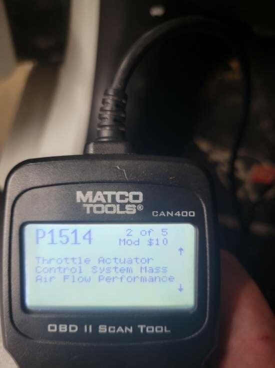

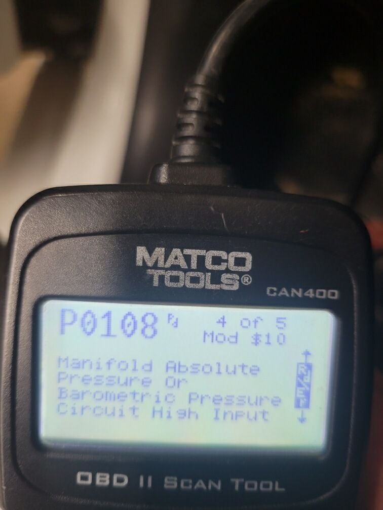

I’m stuck car starts and dies almost instantly. Shows reduced engine power. Ran fine when I put it away for the winter, this spring I put new intake gaskets in and it won’t run now. Entire top end is modified just stock bottom and has stock computer. Professionally dyno tuned after all mods done. Here’s the codes it’s throwing. Any input greatly appreciated.

Can you read the MAF data PID and also the MAP....at key ON engine off MAP voltage should be high...at idle it should be low voltage...with the MAF if you can get it running what is MAF in grams/second...what sets the P1514 is the MAF airflow vs. what it should be reading from the MAP sensor...why don't you take it back to your tuner ??

The MAF has been removed and deleted it’s on a base MAP tune. I thought maybe the MAP sensor was bad so bought a new one and still doing the same. That’s the part I don’t understand is why it’s throwing MAF related codes. My tuner is almost 2 hours away and I don’t have a car trailer so if I can figure it out myself would be better

The MAF is removed you said so clearing that DTC from your scan tool won’t work…a tuner is needed to do this so that DTC doesn’t come back.
