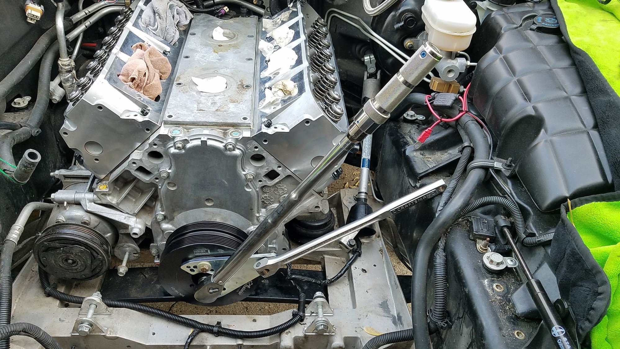

Are you doing the HB yourself? I see you are in Illinois. I can lend you the tools if you would like to torque the ARP bolt per the instructions. I'm in the NW burbs of Chicago. As long as you have a 1/2" drive torque wrench and a breaker bar pretty straitforward, see pic. I also have the proper tools to remove and reinstall the HB. You can also pin the HB if you are ever going to put any kind of blower on your car. I could ship the tools and then you could ship them back, depending on where you live.
