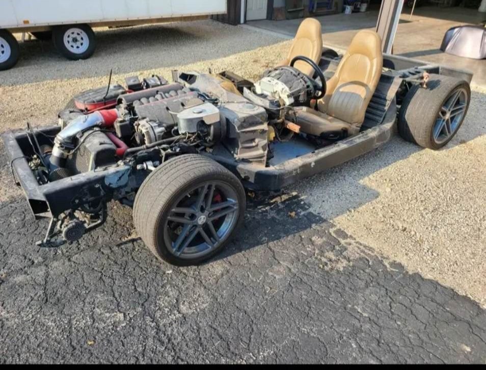

Hello! I've got the the chassis and drivetrain for a C5 that I'm building into a dune buggy.
Since there are no doors, they're always reading open and keeping the lights (which also aren't there) on and killing the battery if it's left connected.
Anybody have any idea on how to disable the door ajar sensors or make them read shut?

Originally Posted by frodo84
Are you planning to use it on the beach? Pretty low to the ground, will you raise it somehow?
let's reword it as "dune buggy style". I'll eventually put off-road tires on it for looks, but it won't see much off-road time except for grassy fields and such.

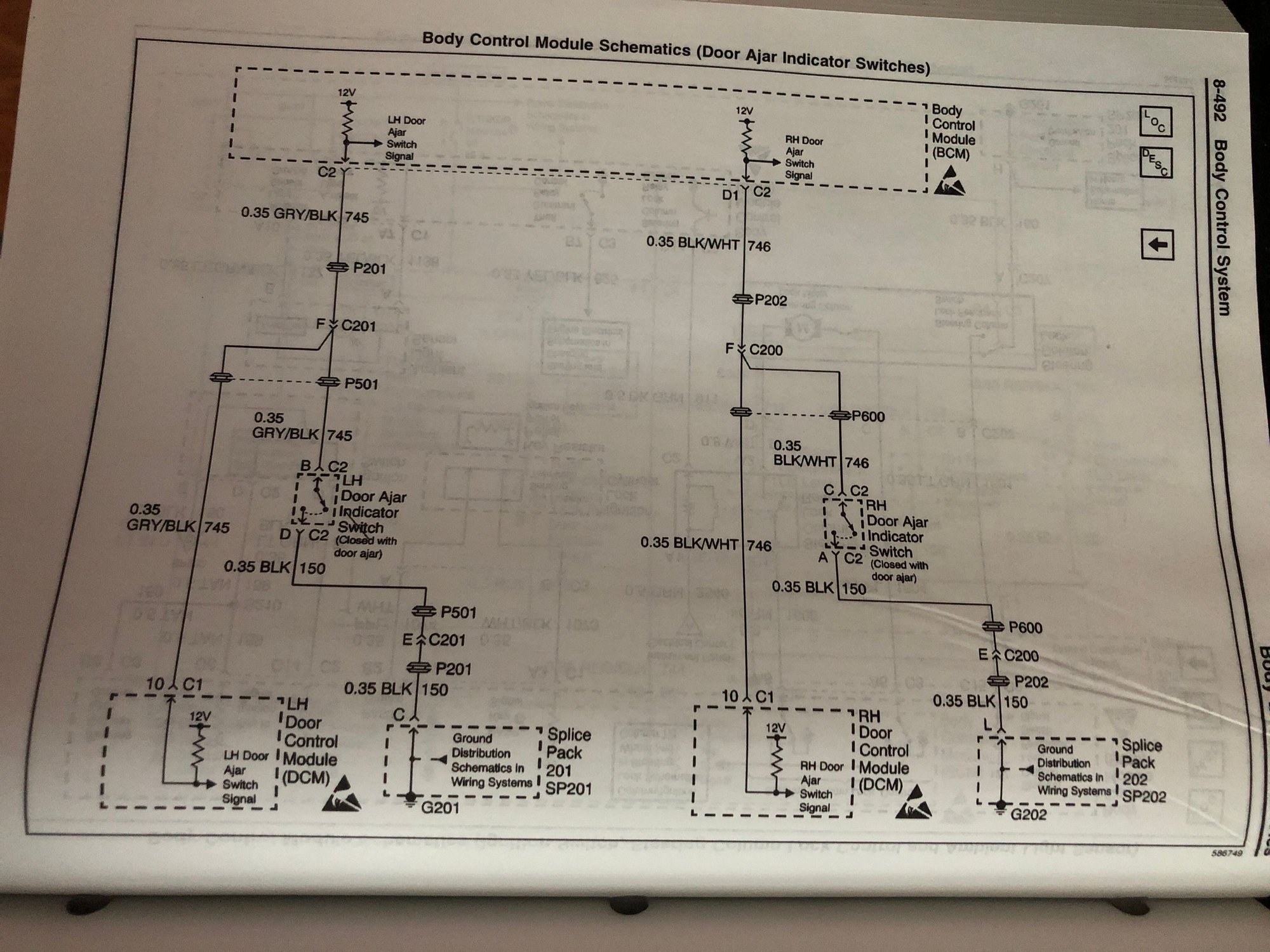

Old Jul 2, 2023 | 04:04 PM
Dads2kconvertible's Avatar
Dads2kconvertible
Joined: Sep 2021
Posts: 2,555
Likes: 1,213
Locate this wiring diagram in your service manual. Make the appropriate modifications to send the "closed" signal to your BCM.
2000 model
Old Jul 2, 2023 | 08:48 PM
KingRadyn's Avatar
KingRadyn
4th Gear
Joined: Jul 2023
Posts: 4
2000 model
That actually helps a lot. Thanks mate!
