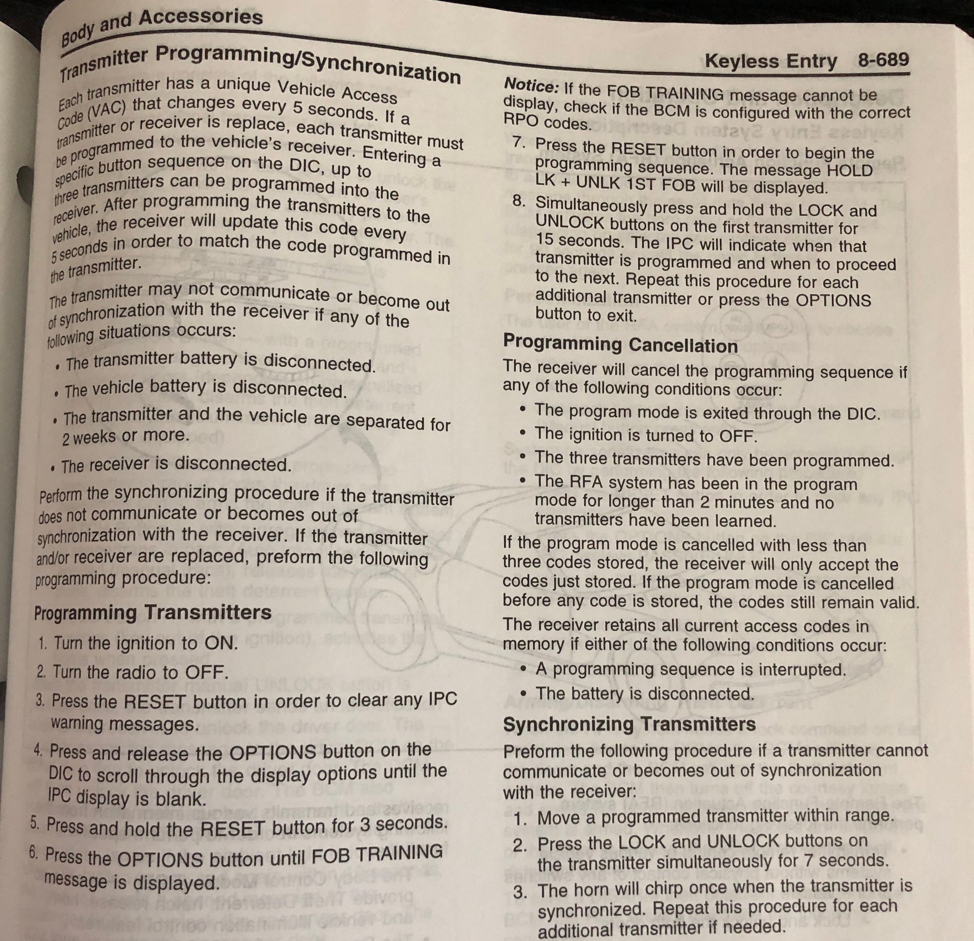

Have you re-trained the fob since you changed the battery?
This is what my 2000 service manual shows, your 2004 might be different.

yes i trained it the other day.
