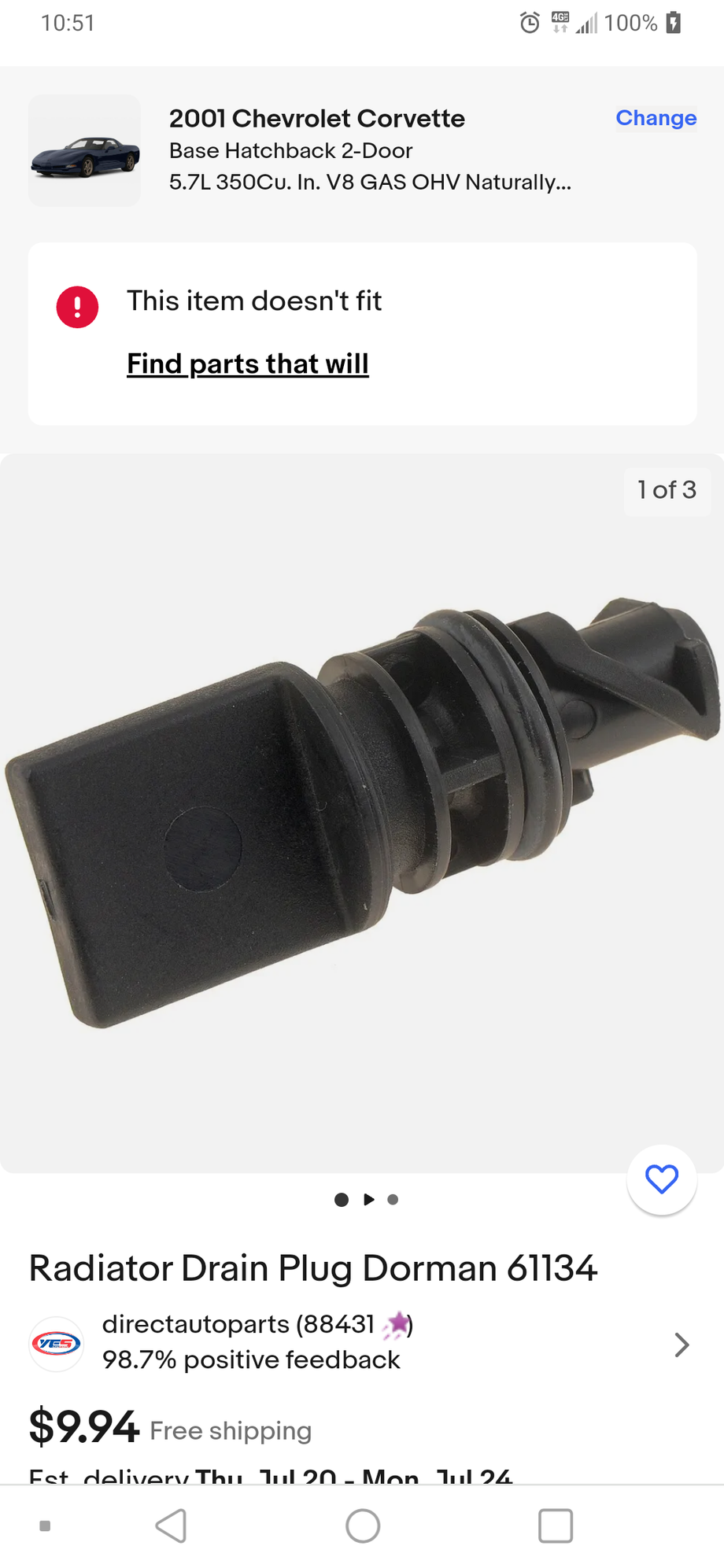

https://www.ebay.com/itm/30416044888...Bk9SR8b1spWsYg

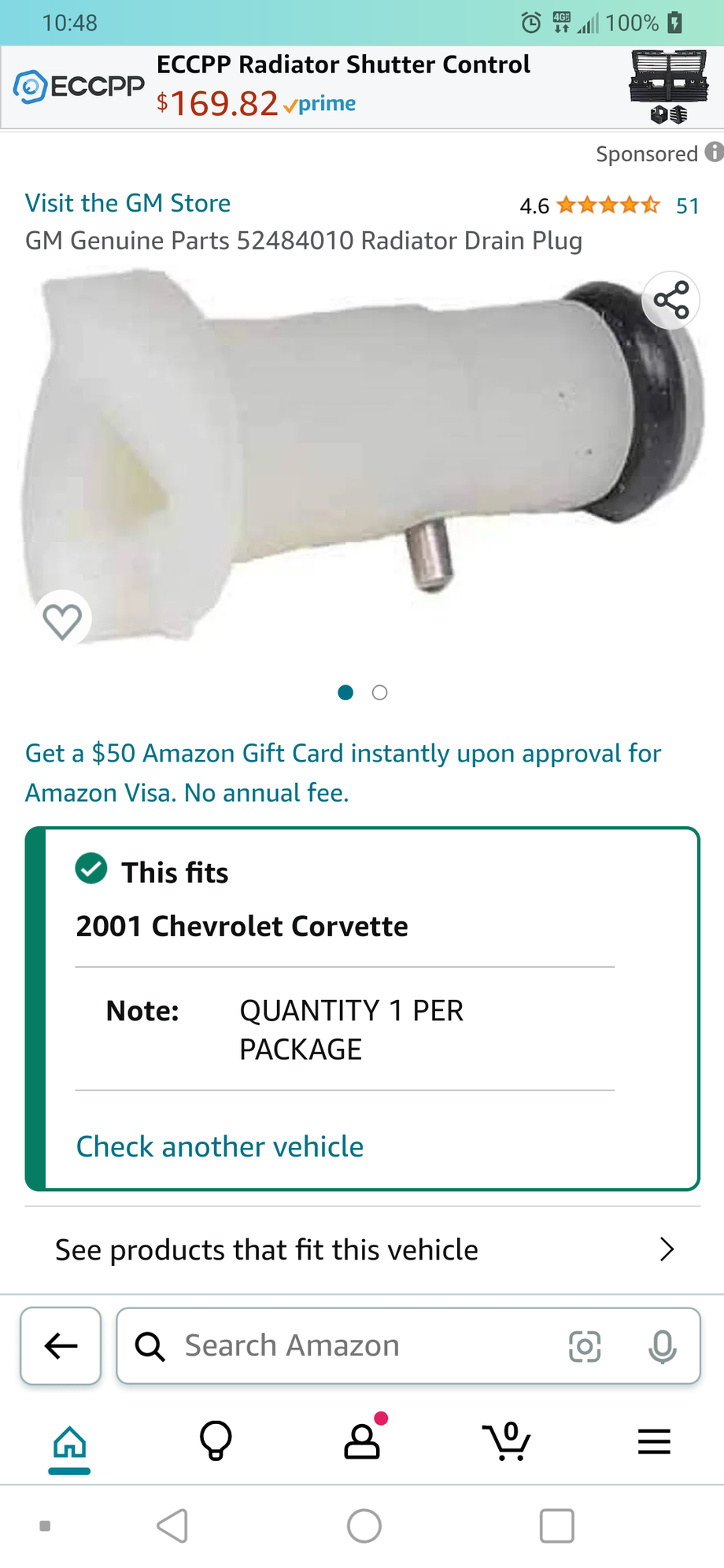

It may be easier with the radiator out of the car. You should be able to use a screwdriver against the roll pin and work it out of the groove. Good luck.
Edit...
I forget what style our cars have. Amazon shows this.
eBay says no to this design.
If it's the roll pin style work it out the groove work s screwdriver. Either the 1/4 drive strips or the petcock gets stuck when you have to pull. I've done this before. Looks like you had the petcock with the big wing. I replace the 1/4 drive with those. Good luck.
