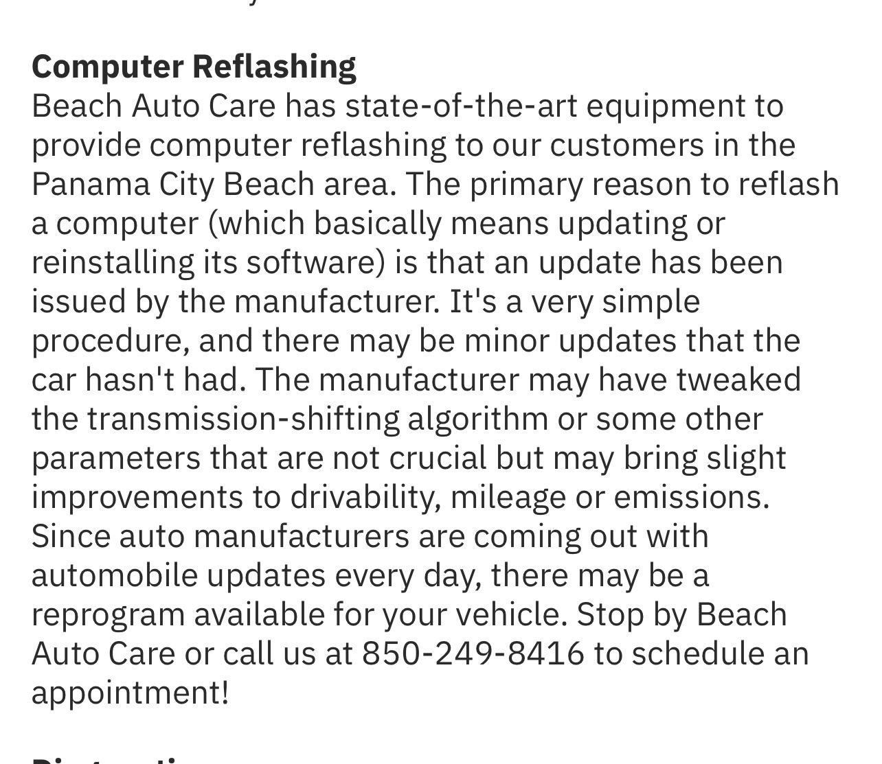

I called Beach Auto Care. They said they "think" they can do it. Cost $299 and a two week wait to get an appointment.

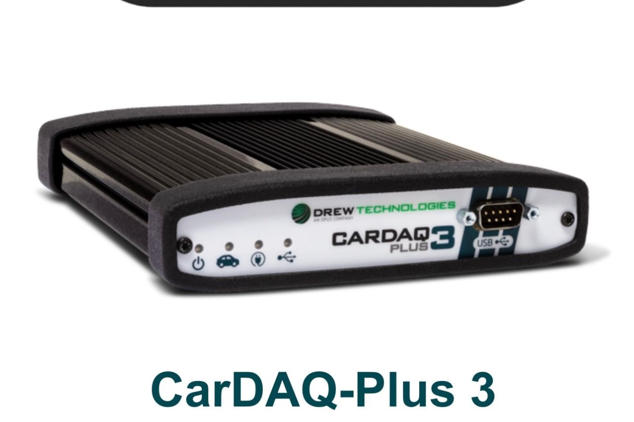

If Diagnostic Tune does do reflashing and has a Cardaq (below) and a J2534 cable they really don’t need the Tech 2 and the hardware to hook to their laptop and connect to the GM website…they don’t need any annual subscription I know of…I’d see if the other shop can do it
