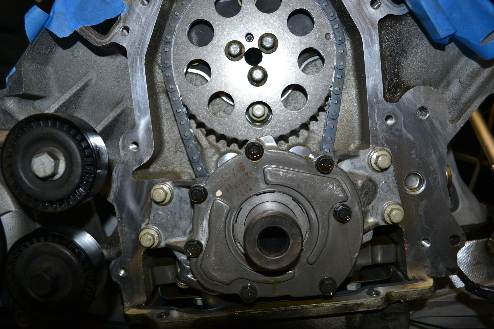

I replaced my balancer, timing chain, and front seal, several years ago. Did have to lower the front cradle about 3/4", in order to aid steering rack removal. With respect to the oil pickup, it's held to the oil pump with 2 bolts. You can unscrew the 2 bolts, and if you're VERY CAREFUL, remove them without dropping them into the oil pan. Then the pump can be disconnected from the pickup by carefully prying the pump and pickup apart. The pump and pickup seal together with an o-ring, so don't drop that into the pan.

You can replace the oil pump without dropping the oilpan here's a pic from my build
