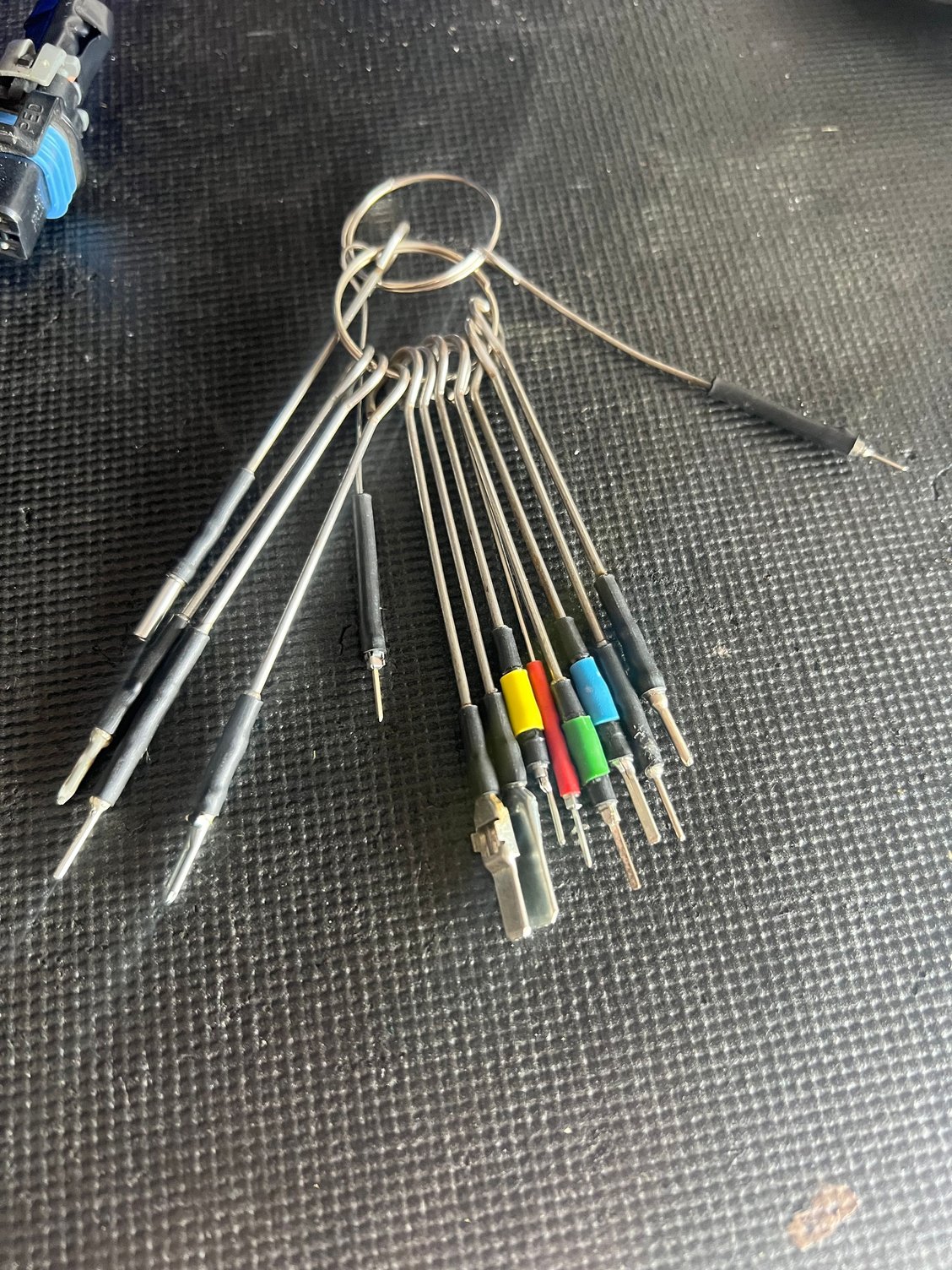

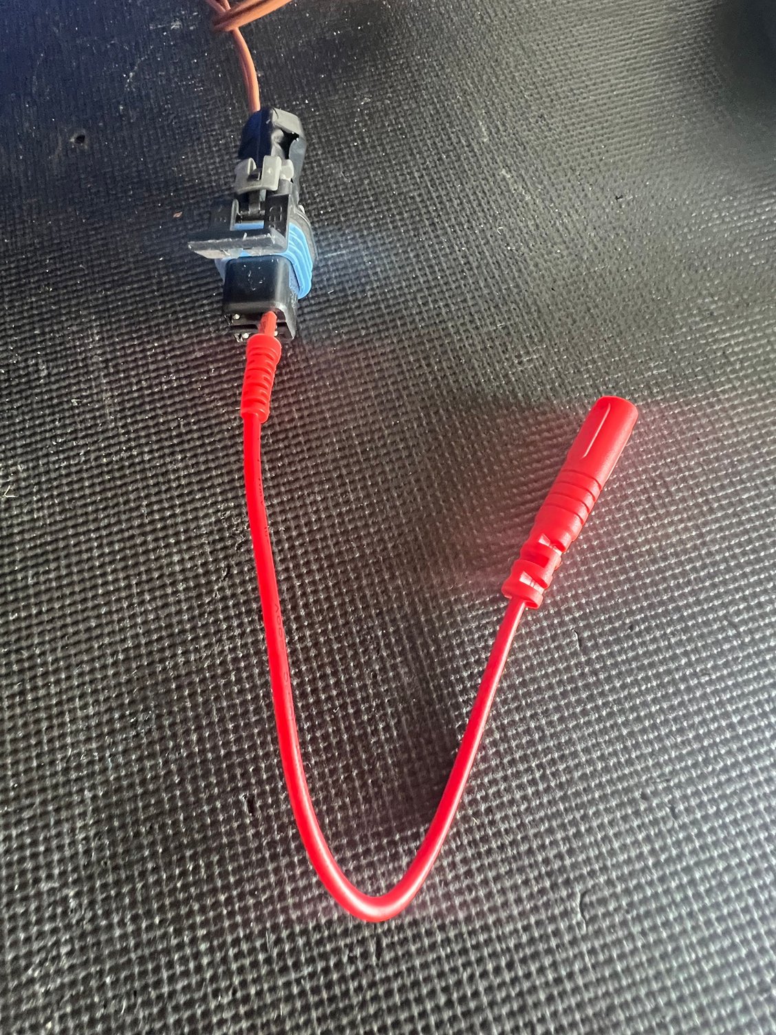

The OP sensor is a 3 wire sensor that uses a 5 volt reference, a signal wire and a sensor ground...all 3 go to the PCM..if you have some high resistance or a bad connection in that circuit the pressure will fluctuate....to check for "terminal tension' (loose connection) I use either the wire with the same size terminal and if I hold the connector upside down and it doesn't fall out it is good..you can buy this kit with different size pins also.
