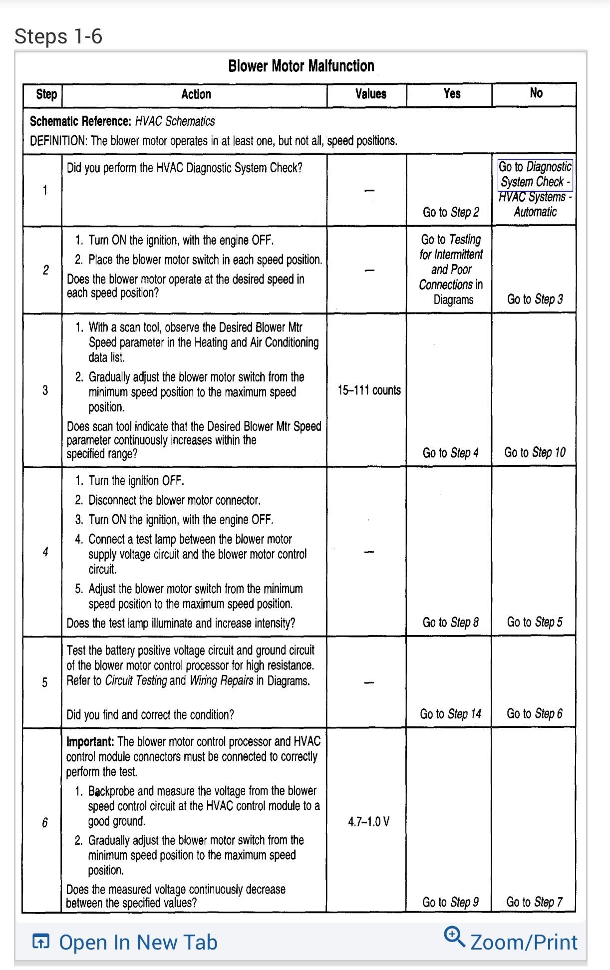

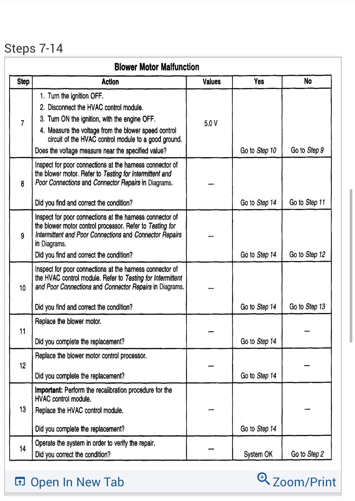

Hope this helps !!
Old Jul 29, 2023 | 04:45 PM
yellow2007's Avatar
yellow2007
Joined: Jun 2017
Posts: 2,568
Likes: 1,183
From: Conyers Georgia
Thanks C5diag
I made it to step 2. Each setting of fan speed works, just not enough cfm's. Step 2 is "go to testing for intermittent and poor connections in diagram......Question is which diagram.

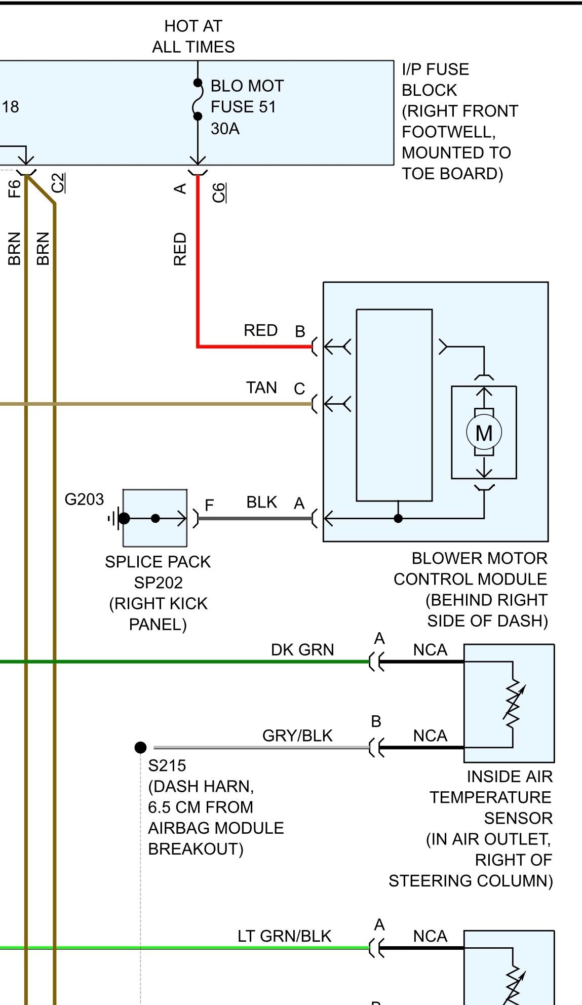

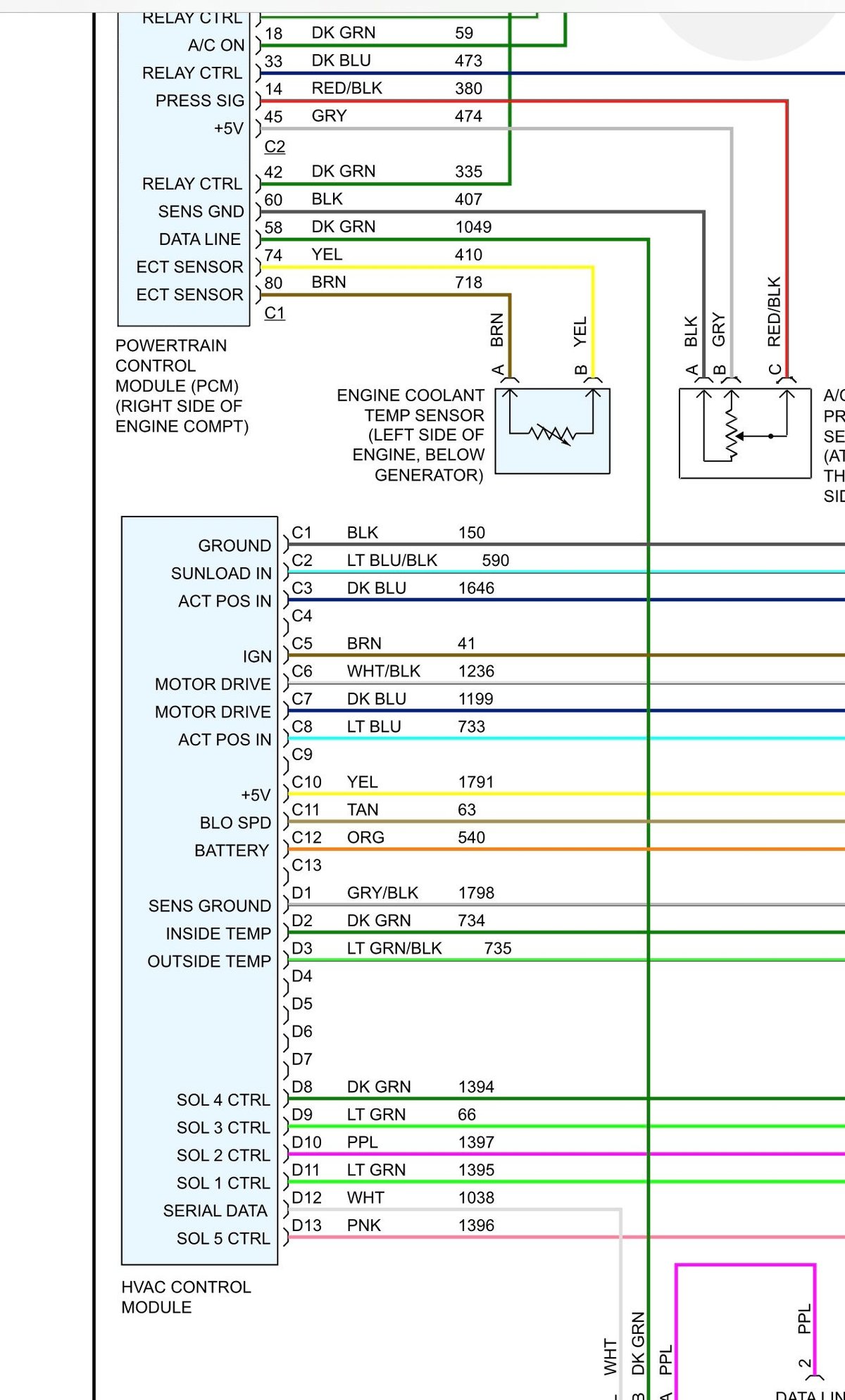

Diagram below…the “control” wire is the tan wire on the blower motor control module…it goes to the HVAC module pin C11 (Blower Speed)…helps to have a Tech 2 or any bidirectional scan tool to perform the diagnosis…a 12 volt incandescent test light helps too.

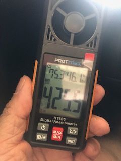

Here are the readings after the re calibrate. I should have taken pre calibrate measurements but my meter hadn't arrived yet.....1st is center vent.....2nd is door vent. Maybe it's just me but I drive my Impala all week and it blows well.

So speaking of the Impala, how about measuring the airflow on that system for comparison?
Old Jul 31, 2023 | 07:41 PM
grinder11's Avatar
grinder11
Posts: 12,864
Likes: 4,667
If I'm seeing this correctly, your center vent is 11° warmer than the door vent. You may indeed have blower issues, but an 11° variance is pretty substantial in my opinion......
Old Aug 2, 2023 | 09:48 AM
redzg's Avatar
redzg
Joined: Mar 2017
Posts: 3,771
Likes: 940
From: Orlando Florida
Looking at the meter on Amazon, the top left group of numbers is temperature, top right group is humidity, and the big numbers are wind speed — though no clue what units. Whatever the units are, the numbers seem to indicate a difference of over 100!

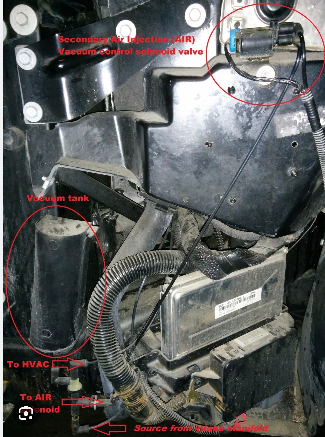

Air distribution is controlled by vacuum so if you have a vacuum leak anywhere from the vacuum line behind the intake manifold to the vacuum reservoir aft of the PCM and then to the HVAC system in the dash you won’t be able to get the air to where you want it…if you take it to a dealership and I don’t know why you would want to take it there expect EVERYTHING in the HVAC system to be changed…don’t be surprised by a 2-3K bill !!
Old Aug 7, 2023 | 07:33 PM
yellow2007's Avatar
yellow2007
Joined: Jun 2017
Posts: 2,568
Likes: 1,183
I bet you that's whats going on which is why there's no errors.. Not the actuators themselves its the vaccum. Now that's something my guy can check with a smoke machine.....Is that vacuum tank below the battery?
