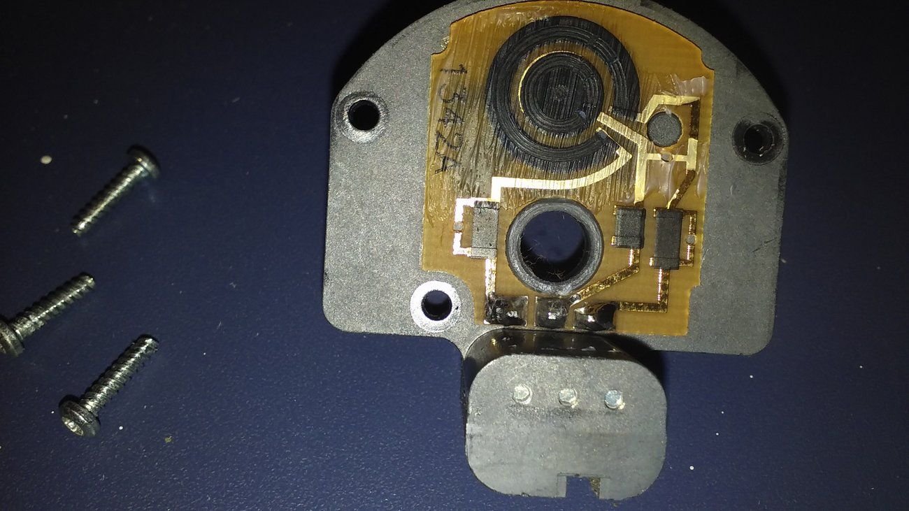

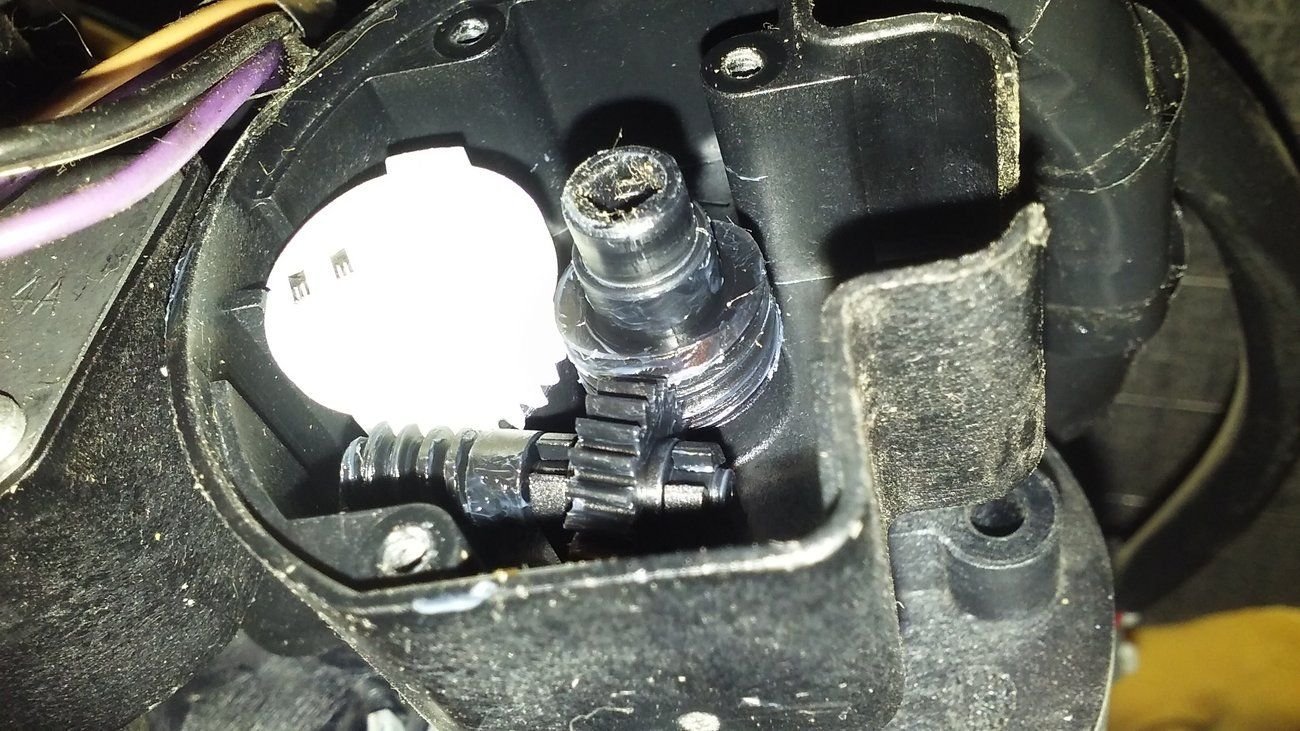

Nice call!!! FWIW, I've had my seat out, and apart, to clean the potentiometer in the seat motor so the memory function would work correctly again. I'm here to tell you it wasn't that dirty, but the seat would stop wherever it wanted, usually NOT where the memory was set! I cleaned what little was in there to clean, and I've had no trouble since. Unlike some, I used NO DIELECTRIC GREASE. Not hijacking, just offering a good service idea to do while OP is "in there."
