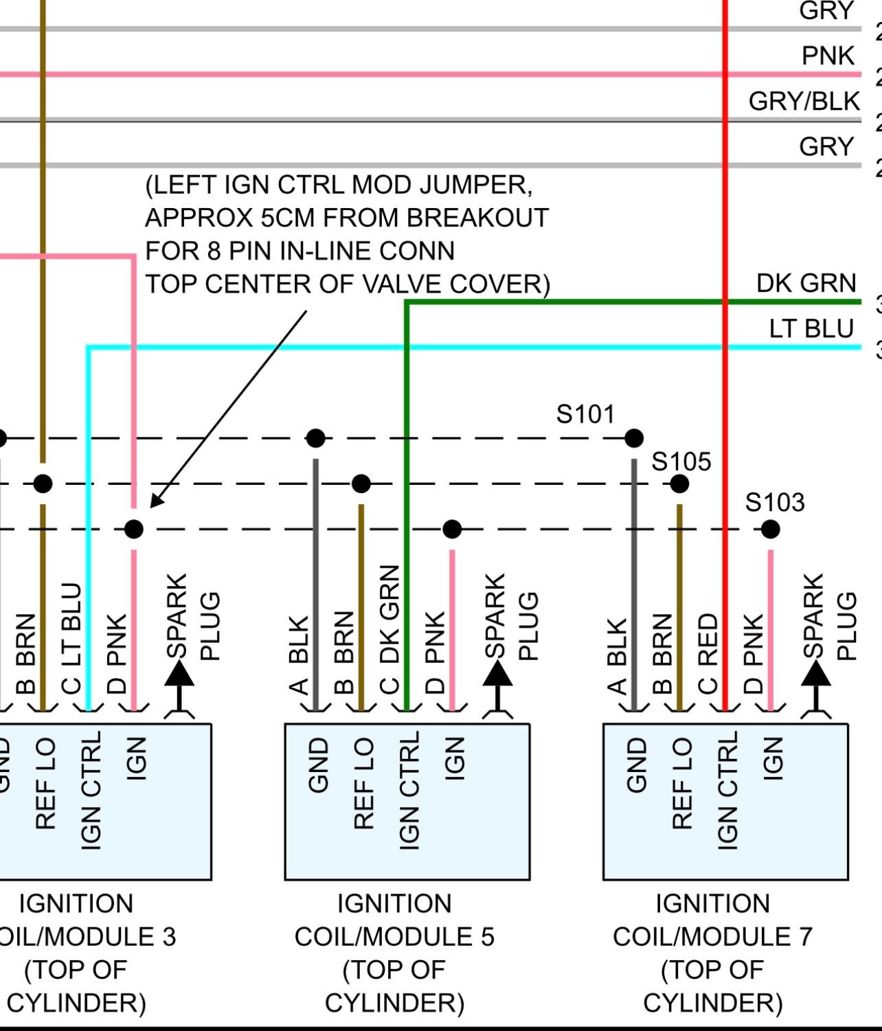

The “coil pack” control circuit (not fuel injector) code tells you that this control wire is either open, shorted to ground, or shorted to voltage…don’t know how good you are with electrical or if you own a 12 volt test light or DVOM…coil control wire is the dark green wire…if you had a scope or a graphing multimeter you would see a 0-4 volt square wave on the control wire with the engine idling…every time the engine computer grounds that control circuit the coil pack will fire the plug…with a test light you can actually fire the coil pack with just the key on…don’t know how far you want to diagnose this…blinking MIL is a cat damaging misfire so you want to fix this ASAP.

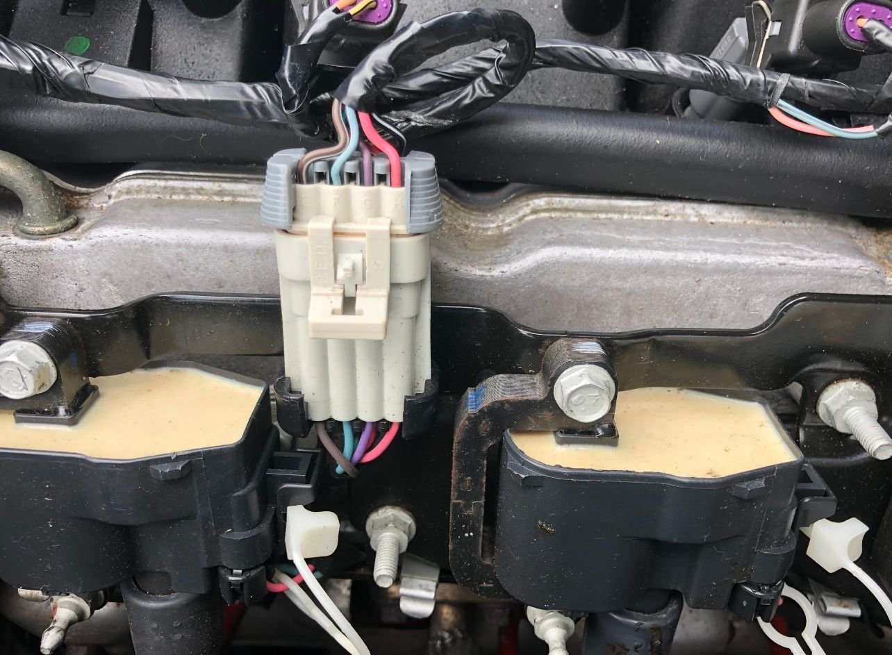

I would check the dark green wire from the coil pack to the connector which is above the coil pack (pictured)…I would make sure that the terminals aren’t spread apart either.

Could be just one loose pin…you can hook up an ohmmeter from the coil pack to that connector and just do the old “wiggle test” and see if the circuit goes open.
