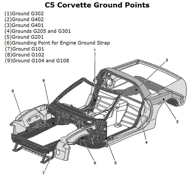

Have you looked at all the grounds that could be applicable?
