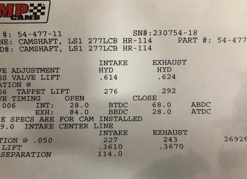

I just got the car back out after installing a rebuilt diff. I noticed once the engine is warmed up (190F) and at idle (40lbs oil pressure at idle) I'll get an occasional ticking. I'm using a Melling high volume pump with a DRM oil cooler. I'm confident that it's only one cylinder on the drivers side. They're LS7 lifters and I've got the bronze trunnion upgrade. The cam is intake .614 and 276. Exhaust .624 and 292. Nothing crazy. I'm guessing 10k miles on the build.

Are you certain the tick isn't normal? LS engines aren't known for being the quietest engines. Also, you list what I think are the gross duration figures. What is the duration at .050 lift? That could help explain some of the valvetrain noise. Injectors on these engines are also pretty noisy. Hard to dianose online. FWIW, I have LS7 lifters (I think all LS engines, except newer DOD engines, use one lifter, and it's just commonly called the LS7 lifter.) in my modded LS7 engined C5. I haven't had any trouble with them, so far.....

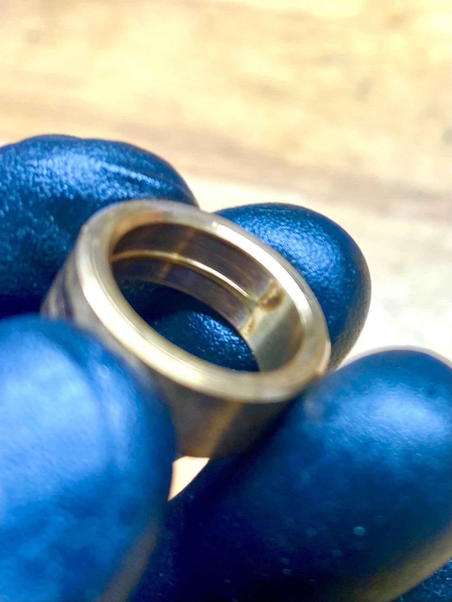

I don’t know for certain that this is the issue. I’ve pulled 3 rockers and they all look like this.

Common failure on those bronze bushings. It’s well documented over on LS1 Tech.
Some companies developed different oiling solutions. Other companies said it was an oiling issue with the engine. Yeah, right.
Do some research.
Myself, I didn’t like the bronze approach, so went with the Tooley series II needle bearing approach with no issues.

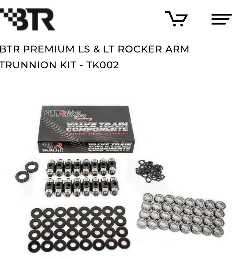

This should be here tomorrow.
I believe I made a mistake with the previous trunnion “upgrade”. I won’t say who I got them from but suffice it to say I didn’t do enough research.

That BTR kit would be my go-to if/when I ever get into it.

Good job. Those will work well.
Not sure how much research there was to do when those came out.
Customers always end up doing the reliability testing. :-)
Many engines used bronze bushed rockers back in the day. But they were pressure lubed.
The modern Hemi uses them now. Again, pressure fed.

Like Ron I decided to go with a premium needle bearing to replace my "upgraded" bronze bushings. These noticeably quieted down the valve train and so far seem stable.
