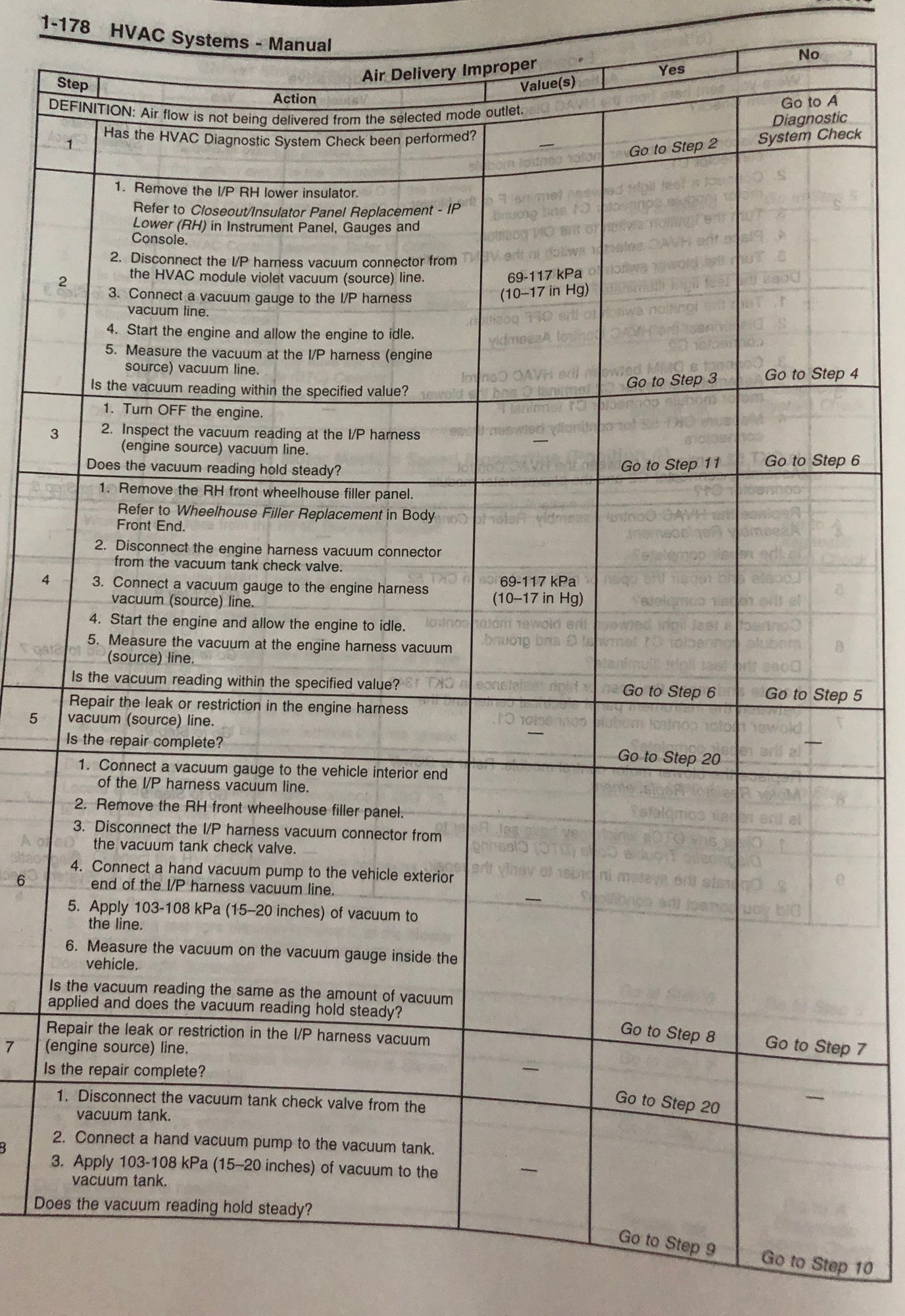

Here are a few things to check from a 2000 manual. Your 2003 manual may have a different list.

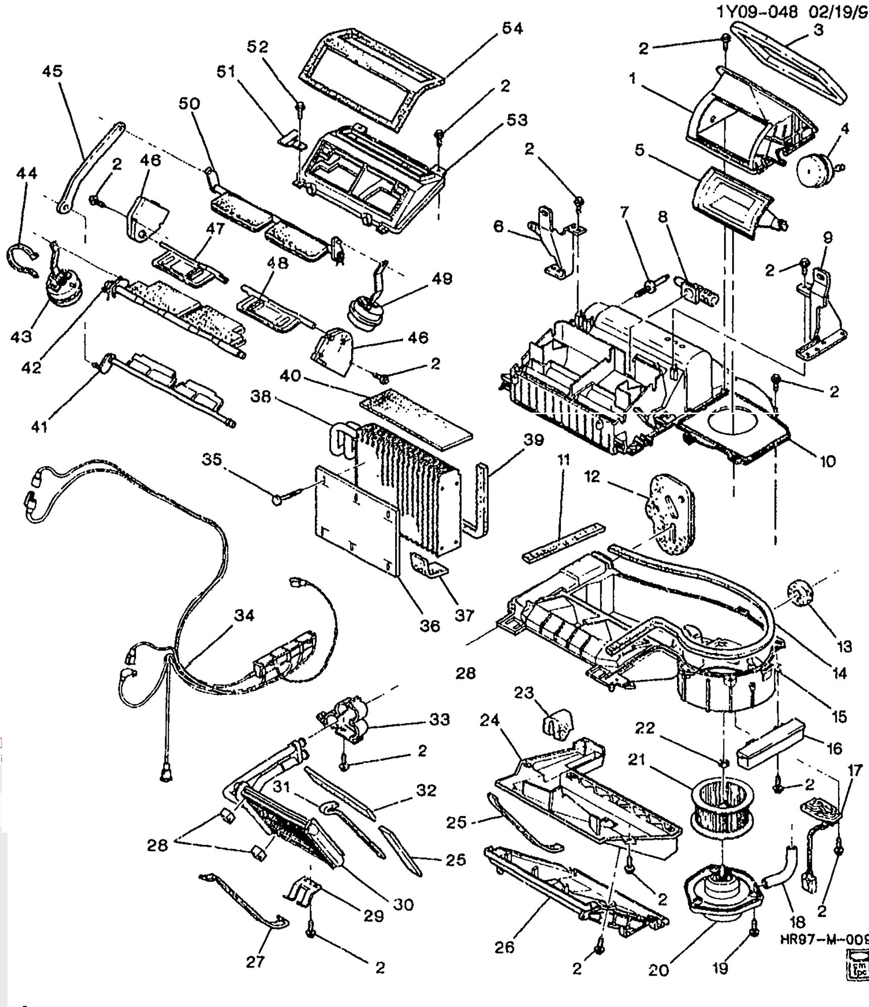

I almost hate to ask, but is it completely omitting the recirculation, or just a reduced version of recirculation -- i.e. if driving through the malodorous zone you were to select 'fresh' does the odor get worse? Curious as to whether the duct operator is broken or stuck, or if it might just be age degraded foam seals on the duct door. On the parts manual diagram, item 1 is the air inlet, item 5 is the air inlet valve, and item 4 is the inlet valve actuator. Since the rest of your vacuum controls sound active, it seems unlikely there is a vacuum source issue, wonder if something is just simply stuck.

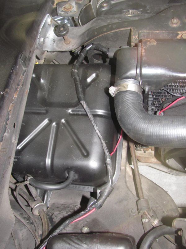

I sold my beloved Toronado in 2015 and bought my beloved 2003 Corvette. Here's the Generation I Toronado vacuum tank:
I had it removed, re-sealed, and repainted. Large tank, because it was designed to hold sufficient vacuum pressure for the headlight door actuator to function after engine shutdown.
Vac tank is tucked inside the driver's side fender. Photo taken when I had my carb overhauled and a lot of other engine & AC work done.

‘Tank’ would be a bit of an overstatement — it’s on the order of 3” X 6”. And that may be optimistic.
It should not be possible for either the vacuum line or reservoir to be the cause of your issue. If the vacuum source is missing, the HVAC will have no control of the air path, and air will be coming out the defroster, dash, and floor vents all at the same time.
