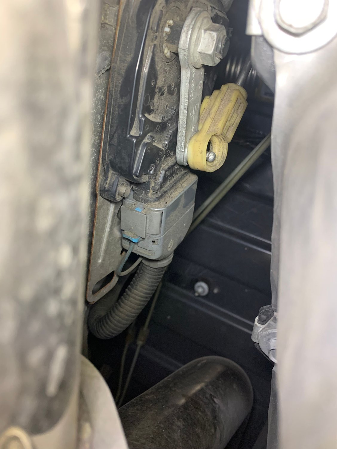

Hey guys my shift linkage is worn out at the transmission of my 2004 corvette. I was able to fix it enough to get home. Has anyone his this problem and have any recommendations on how I should go about fixing it. I was planning on buying a whole new line and replacing it myself or taking it to a shop to have it done. It doesn’t look too hard on videos.

Looks like you need a whole new shift cable. Common problem. How many miles are on your 2004?

You need new rubber/plastic bushings. Do a search for new C5 Corvette shift cable bushings. I believe there are also cable bushings under the console on the shifter end, IIRC......

Well the bushings were both rotted and in the process of replacing the front bushing I broke the line anyway. Also my 2004 corvette has 60,028 miles.

Can’t remember the part number , but I just went to Auto Zone and got a Dorman assorted grommets , cost I believe $5.00 and it did the trick👍. The rear side is much easier to repair

The good thing is that the tranny side bushing is very easy to replace
