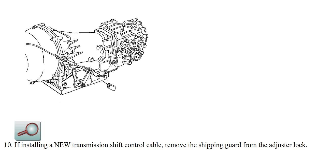

The Red plastic lock is only for shipping. It is not needed after install. The assembly that it comes attached to locks in place by itself.
The Red clip is not used.
Always good to have the service manual for reference......
