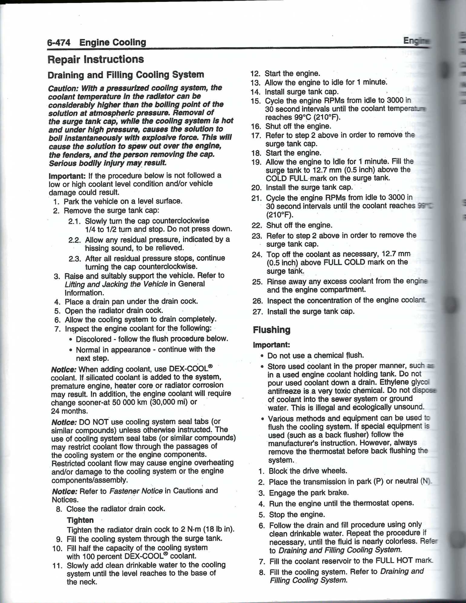

Here is the FSM method.
Thanks Jim

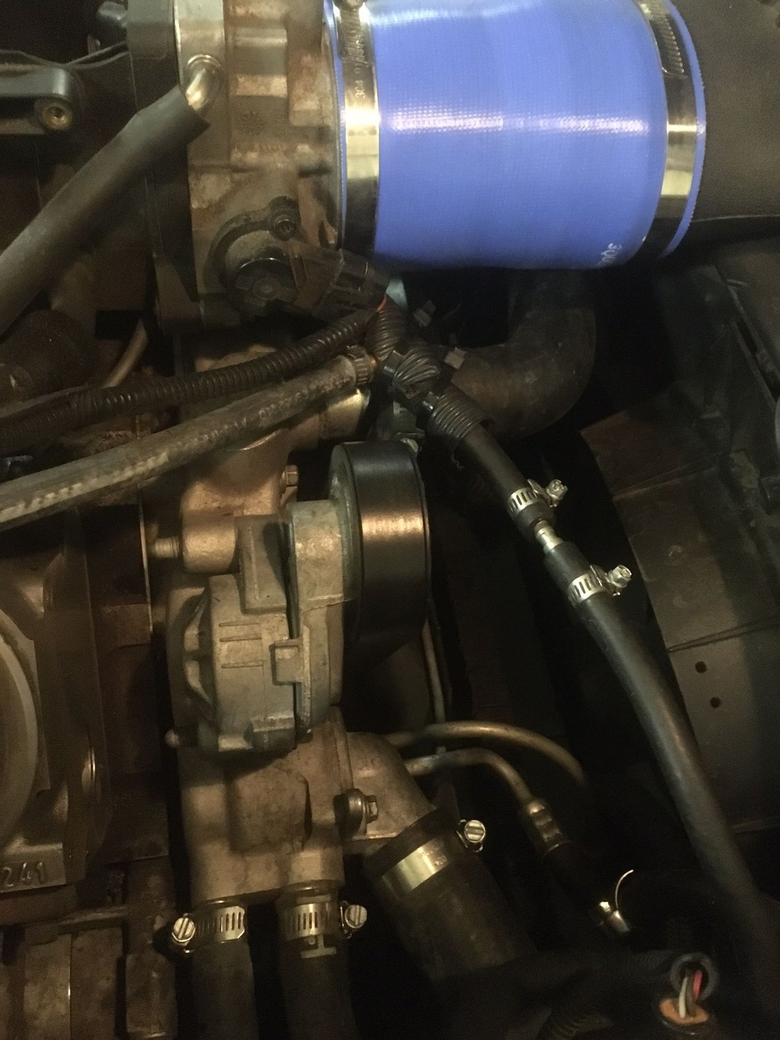

2001 and later C5's do not have rear head coolant air bleed piping, but the heads do have the ports with bolted on block offs. These cars can have the rear ports activated when the intake manifold is off using a modified front pipe from a 2001 and later car and extending 1/4" heater hose to tee into the front coolant air bleed line which goes from the throttle body to the radiator on the right top side. There have been some reports blaming lack of rear head coolant air bleed piping for on track loss of cylinder #7. Maybe old wives tales but the last time I had the intake off, I added rear head coolant air bleed piping and hose to my 2001.
The picture below shows the rear head coolant air bleed hose coming from the left to a tee in the coolant air bleed hose coming from the front ports on my car ( I bypassed the throttle body a decade ago):
After a coolant change, I disconnect the connector with two band clamps, block the hose leading to the radiator and run a clear plastic hose from the coolant air bleed system to a bucket on the floor by the passenger fender.
When the engine is run in this configuration the coolant system tries to pressurize, forcing coolant and air bubbles out the coolant air bleed system through the clear plastic hose into the bucket. Be prepared to stop and refill the surge tank from the bucket several times. During the last coolant change on my car, about one and one half gallons mixed with air bubbles came out of this cobbled up bypass before the bubbles finally stopped. The reason for the clear plastic hose is so you can see whether the bubbles have stopped.
After the bubbles stop, I reconnect the connector and top off coolant.
