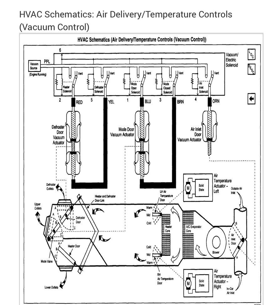

Old Sep 1, 2023 | 08:27 PM
yellow2007's Avatar
yellow2007
Joined: Jun 2017
Posts: 2,568
Likes: 1,182
From: Conyers Georgia
Also see here. The blend doors are electrically controlled but vacuum operated. A break in the vacuum would not generate an error code but a faulty solenoid would.This is courtesy C5 diag

According to the diagram, I should be able to access the air inlet door after the blower motor is removed? correct?? I need to check that actuator...it may be stuck on just outside air.
If I'm not mistaken yes but only the passenger side. The drivers side requires dash surgery
I do not think you will find that the air inlet door will be the cause of your problem. There is some difference in maximum airflow between the two settings but it is not as noticeable as you describe. One of your earlier posts describes air flow coming out of the heater and defrost vents intermittently. This is not normal and suggests you have an issue with your vacuum source, vacuum reservoir, plumbing, or a leaky vacuum actuator.

I have done some testing.. When I change the mode, the air changes from dash to floor to windshield depending on the setting.. tho, when on dash setting, there is some "bleeding" thru the floor and windshield vents. The reason I asked about the fresh air intake, as that does not seem to change. Seems to be stuck on outside air. So a bad actuator may be the cause there.. The blower speed that sometimes goes into "Hyper" mode when a bump is hit is puzzling as it does not occur each time.
