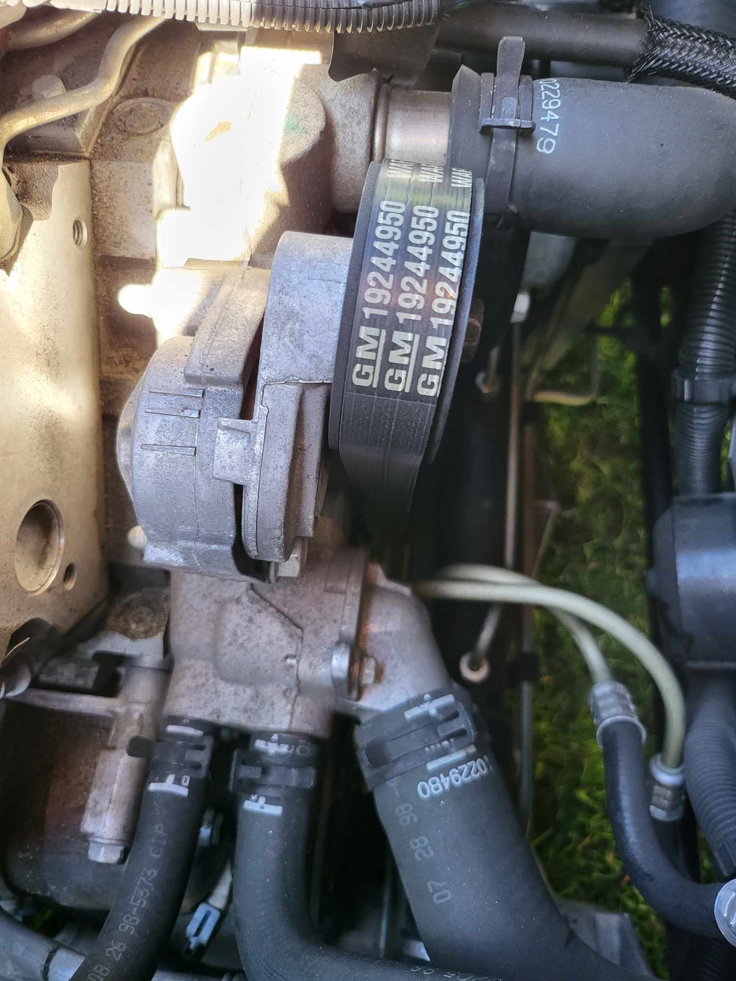

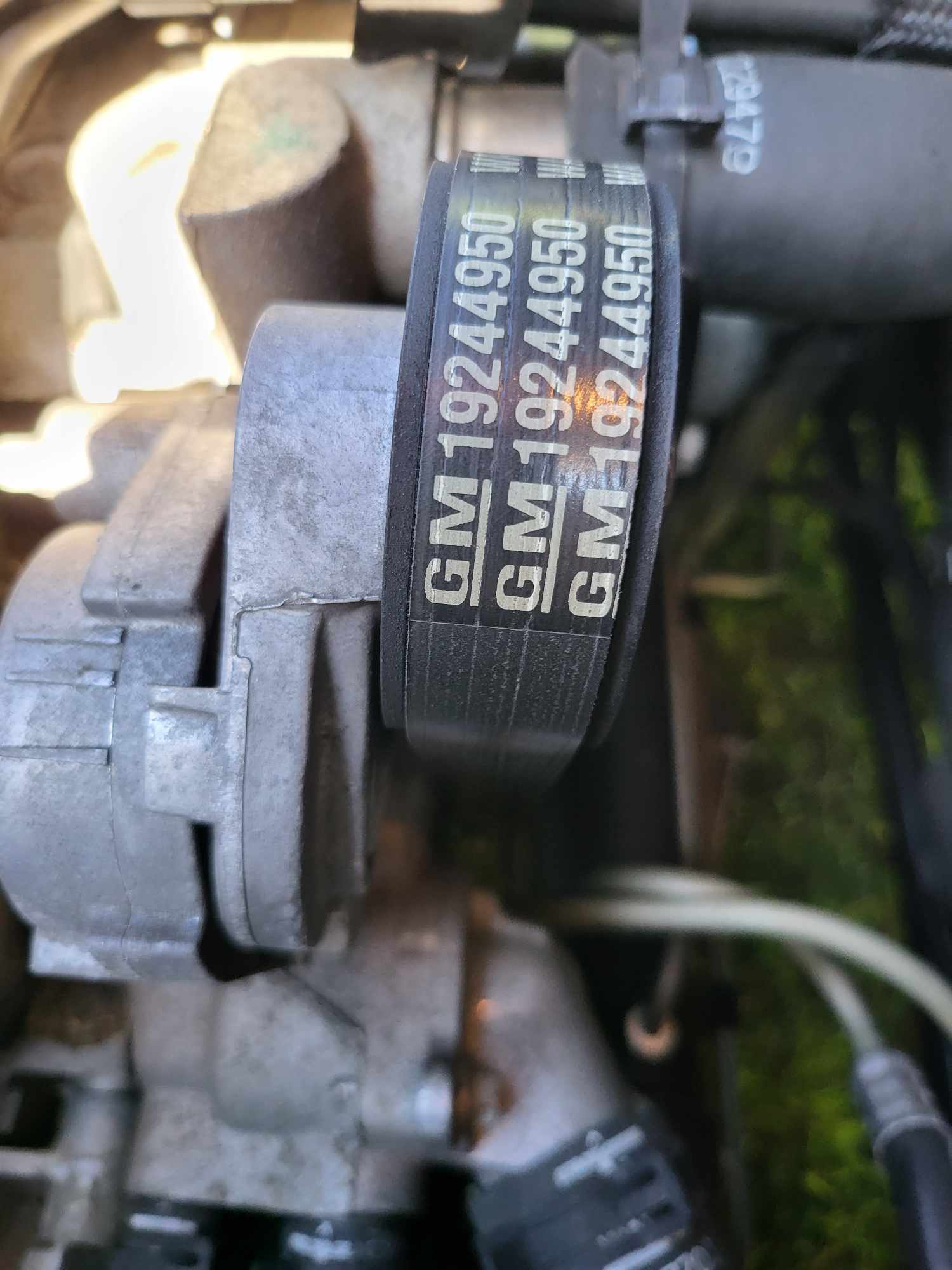

Car has been running fine....it just looks off and I can't find pics online that shows it more clearly to compare.
1999 C5 Vert base
Thanks for any help.

This is what mine looks like (2000 vert). I put a short bubble level on it, it's pretty close to level. If yours is tilted much I would investigate why.
Those tensioners are known to go bad. You can put a wrench on it, apply pressure clockwise to give the belt some slack, then pull the belt off the water pump pulley and let the tensioner go back to the rest position. Looks like the bearing might have some wear on it. Try turning it by hand, can you wobble it or does it feel crunchy?
These last two show the gap on the back side. Hard to tell for sure but your gap looks bigger to me, as if your tensioner bearing is worn.

I would replace it.If it breaks you know it will be at the worst and most inconvenient time.Very easy to replace it and eliminate any worries.

Double check the harmonic balancer too. They can walk either direction.
Tensioners are cheap, might as well give it a shot.

Correct serp belt but I also think it might be the tensioner. I just replaced all my pulleys and tensioners. Easy peezy. Cheers!!!

Thanks so much for taking the time.....based on these pics, it does look like it's "off"/tilted a little....I'll put a level on it and see, but even the lines, based on yours, is way off. I really appreciate you taking the time.....I'm nervous to pull the belt and have something just not go back or completely break off. It's running right now, better to drive it to a scheduled diagnostic appointment and they can repair it once it's off.

Yes your tension pulley needs replacement. The line tells you when to fix it. Rockauto.com

What "line" are you talking about?? If you're talking about the 3 lines behind the tensioner, and the "pointer" that's part of the tensioner, that hasn't got anything to do about when the tensioner should be replaced. It's there to gauge how much the Serpentine belt has stretched/worn, and is indicative of when the belt needs replacing....
Nope
https://www.corvetteforum.com/forums...post1570787484
Traditionally, the markings on a tensioner are to visually inspect for belt wear. Usually there is a minimum and maximum mark that the opposing line should reside. If it is outside of this range, it can indicate the following:
1) Belt is too small
2) Tensioner has relaxed
3) Belt has stretched or is damaged.
