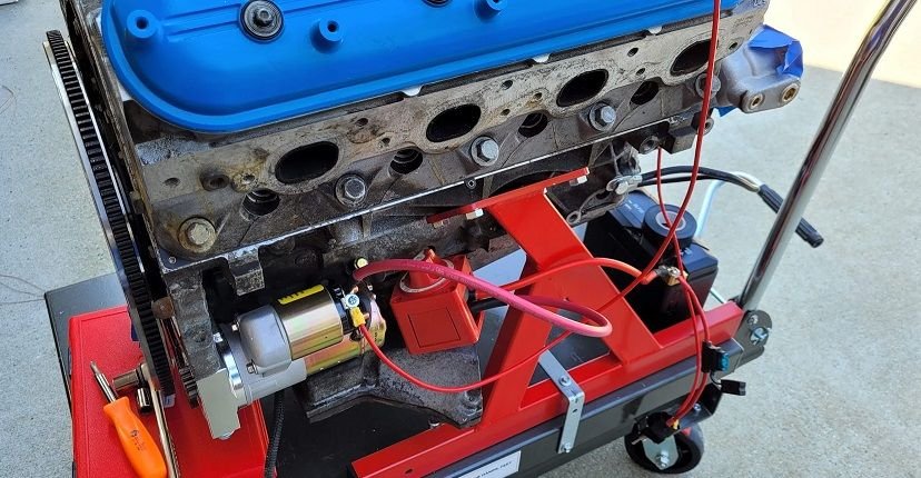

I have an LS6 from a 2002 Z06. It was partially apart when I got it, so I've never had it together to run. No intake, no electronics, and it is sitting on a lifting table. I added a starter and spun the engine for a dry (and cold) compression test. 180+ in 7 cylinders. Cylinder 4 was at 90 psi, both dry, and with a few squirts of oil. All of the valve springs appear intact, including the ones on cylinder 4.
I have a borescope on the way. Any tips on what I should be looking for, and any other tests I could try before pulling the head? I should take a video of the valvetrain, at least.
Here's the test setup. Thanks!
