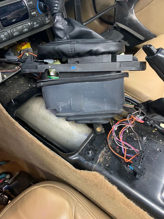

A bad bushing at the transmission end is the most common failure and the plastic adjuster needs to be secure. Try selecting Park and Low then look to see if the transmission cable moves at the transmission for both and the arm on the transmission moves with it. if the cable doesn't move at that end then the shifter end of the cable might have popped off the bottom of the shifter or the cable is bad. To check that, the console needs to be removed and the four shifter mounting nuts too, use caution lifting the shifter too much because the plastic cable outer covering doesn't bend much and can break. Stop lifting when you feel slight resistance. Use a light to see if the cable end is attached to the small shifter ball and moves with it when shifting to the Park and Low extremes. If the cable end isn't connected to the shifter ball try pushing it back on with a long screwdriver.

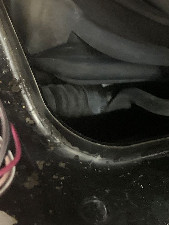

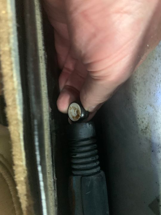

well its the shifter cable end for sure. how do i remove the interlocking cable ? does it just pull off towards the rear of the car?

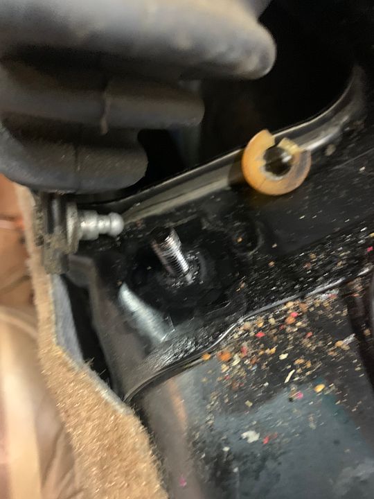

still cant get the inter locking cable off.
not having much luck putting in the dorman 14055 white bushing does any one have a favorite bushing to use?

thanks, i found the dorman 14055 two piece set, i think its the same bushing but only a package of two
i never did get the inter locking cable off
i used an orange Pick from HF and pried out all the old pieces from the cable end , lubed up the new bushing and squeezed it in with some long 11" needle nose pliers . i canted it in the opening and squeezed it in.
then i used the long HF body panel removing tool as a fulcrum and pressed it in place
now time for the test drive
everything works!!!!!
