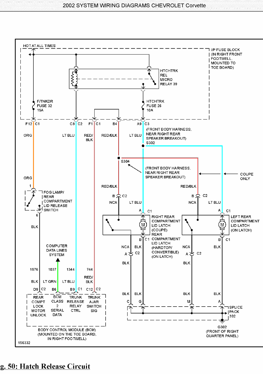

Hey! I was wondering if anyone would know what could cause this issue. My mechanic was diagnosing the passenger door module to see if the unlocking relay was getting power. He manually gave some switches power to diagnose it. Well now my trunk randomly opens. I was wondering what may of happened? Thank you!

You probably won't get much help because we don't know know how he manually give power to some switches in his testing, never a good idea to just apply power to any part of a car's control system.

This might help
If it's really bothering you maybe pull the relay until you get it fixed? From the wiring diagrams it looks like it might be number 39 in the passenger footwell.
