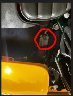

1. Where would the harness connection be for both headlights on a C5?
2. Even though neither headlight motors are making other than the normal noise when operating, could one of the motors still be bad ?
Thanks
The harness is just below the headlight on both sides. One motor could be drawing enough amps to blow the fuse but that is unlikely.
