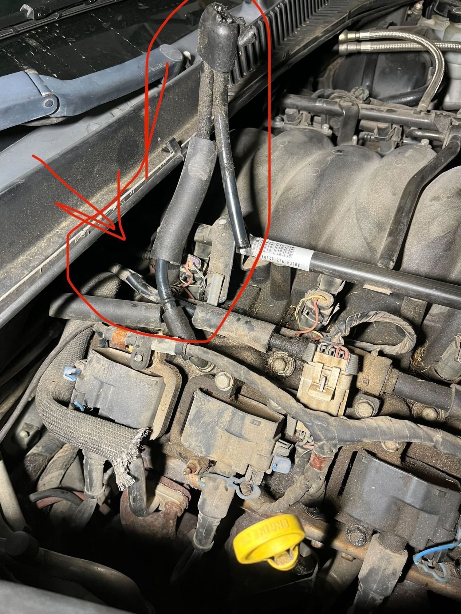

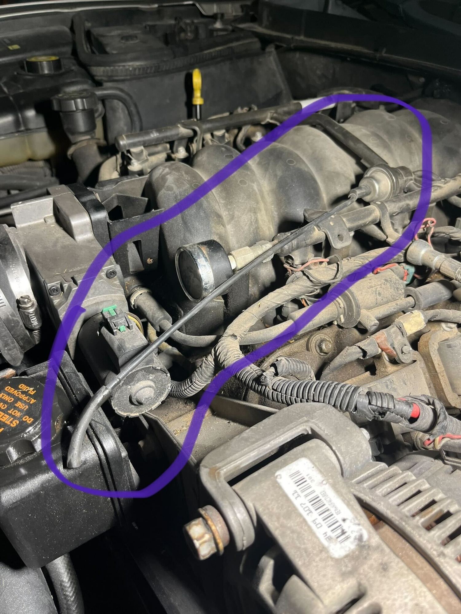

Working through the TLC on my new to me C5. Found these unplugged lines that doesn't appear to be critical, as the car runs and drives fine. Purple on looks like perhaps a vacuum line to the fuel system? I can't find the connection. The red lines seem to be the PCV system from what I can tell. Identifying part numbers and replacement procedure would be helpful.
Fuel system vacuum line?
PCV valve?

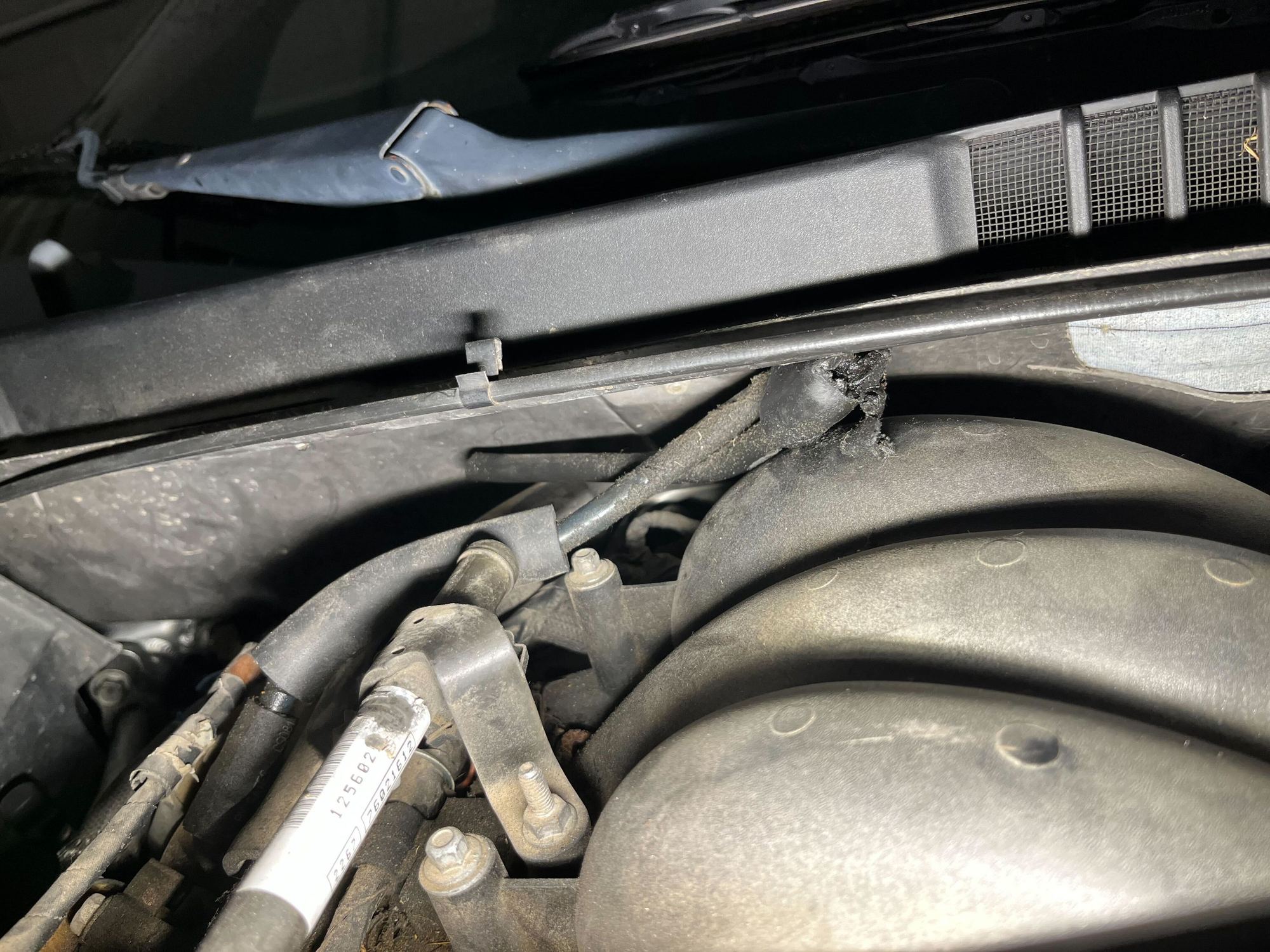

Bottom arrow line goes back to intake, the top two are connected together at a severed connection.

Looks like its the PCV line system (red arrows):
https://www.summitracing.com/parts/a...0aAkYqEALw_wcB
ACDelco GM Genuine Parts PCV Valve Hoses 12558673

That purple circled item in your 1st picture looks like the FPR (fuel pressure regulator) vacuum line. It's pretty important!

The purple encircled hose goes to a small port on the air intake before the throttle body, it isn't under vacuum but is supposed to vent gas fumes in case the regulator valve develops an internal leak.

I took off my air intake and cannot find any connection for it. I have a K&N air intake and the throttle body doesn't look to be original. Do I need a converter kit of some kind?

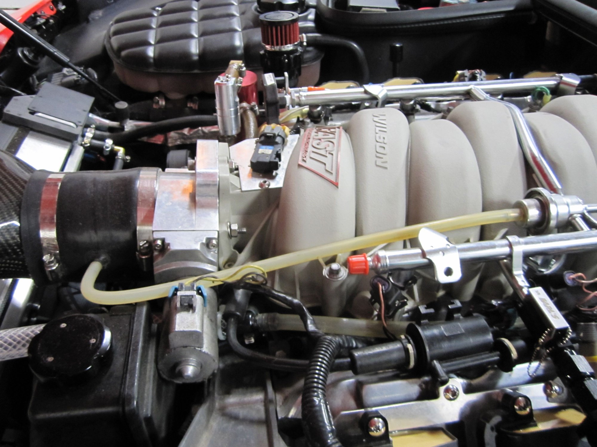

Here's a picture of the fuel regulator vent hose. This hose is silicone that replaced the worn out factory hose, a barb fitting connects to the black aftermarket air intake tube.
