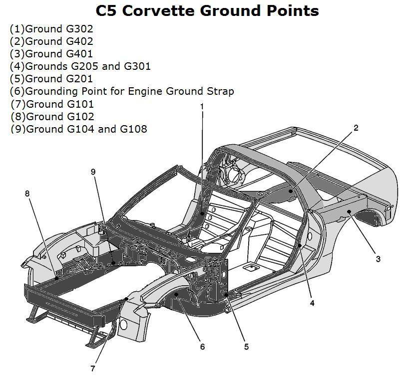

I have checked the fuses and cleaned my engine bay grounds. Again, hazards work and so do my DRLs. My signal is the only thing not working.

Could be a multifunction switch- I compiled a list of other easy things to check.

Old Oct 28, 2023 | 01:37 PM
Tony Corvette's Avatar
0Tony Corvette
Former Vendor
Joined: May 2022
Posts: 128
Likes: 17
From: Texas
